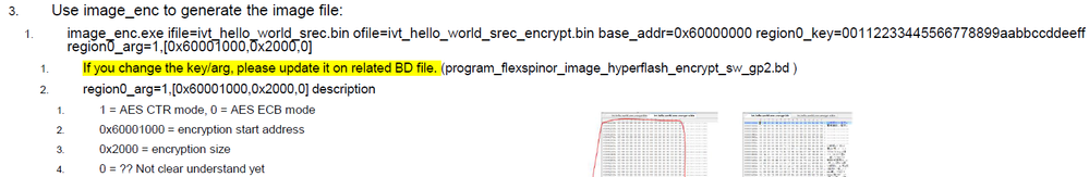

I got doc from FAE, but I want to confirm some step.
Please check.
1. For pdf page 3 "Tools", I got image_enc.exe from FAE and rename to  ”image_enc.exe".
2. In page "Project modification", SDK Example: I use evkmimxrt1015_igpio_led_output SDK and generate evkmimxrt1015_igpio_led_output.s19 file with XIP_BOOT_HEADER_ENABLE=0 and XIP_BOOT_HEADER_DCD_ENABLE=0.
3. I prepare a folder and make all utility file in the same path and create a batch file.
4. In page 7 Generate secure image.
I change to
elftosb.exe -f imx -V -c imx-flexspinor-normal-unsigned.bd -o ivt_igpio_led_output_srec.bin evkmimxrt1015_igpio_led_output.s19
My script is "image_enc.exe ifile=ivt_igpio_led_output_srec.bin ofile=ivt_igpio_led_output_srec_encrypt.bin base_addr=0x60000000 region0_key=00112233445566778899aabbccddeeff region0_arg=1,[0x60001000,0x2000,0]"
I made a tool to remove first 1KB data.
My script is "RemoveBinaryBytes.exe ivt_igpio_led_output_srec_encrypt.bin ivt_igpio_led_output_srec_encrypt_remove1K.bin 1024"
My output is ivt_igpio_led_output_srec_encrypt_remove1K.bin.

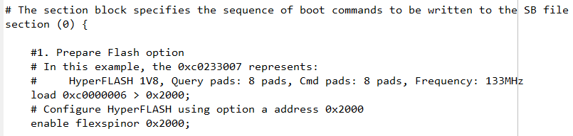

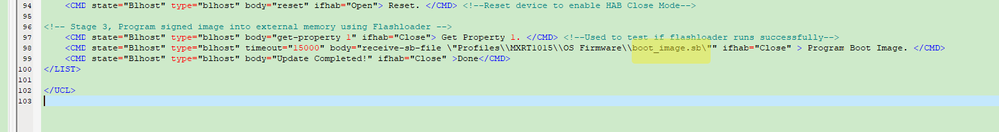

I think the boot_image.sb is the boot_image_encrypt.sb file.
But in this step, I am confused.

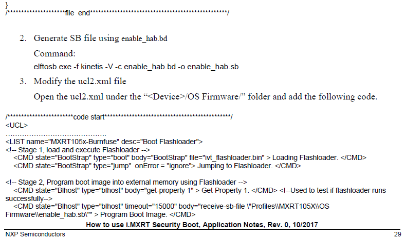

From AN12079, I guess it should modify the ucl2.xml file, but my doc doesn't mentioned about it.
Here is the page 29 of AN12079.
Sorry I change to simplified Chinese here.

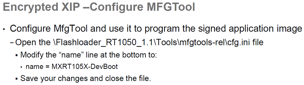

FAE给我的doc中,只提到将Flashloader的ini里面的name改成 name = MXRT105X-DevBoot
我认为这边是有问题的

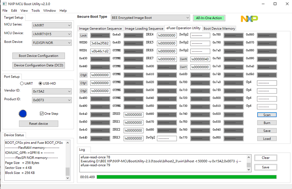

  我这边用命令行的方式已经完全成功了。
  我看你的fuse, 你没有烧写BEE_KEY0_SEL,BEE_KEY1_SEL这些。
   我这边用了engine0,所以烧写了BEE_KEY0_SE,目前已经完全成功使用命令行了。
   当然由于我这边之前用MCUBootutility的时候,已经烧过fuse,所以我就把我bd文件里面关于烧写fuse的部分去掉了,生成的image.sb使用MFGTool烧写没有问题,另外,boot也没问题。

然后你可以在ucl2.xml里面添加烧写burn_fuse.sb的内容
<LIST name="MXRT1015-beefuse_DevBoot" desc="Boot Flashloader">
<!-- Stage 1, load and execute Flashloader -->
    <CMD state="BootStrap" type="boot" body="BootStrap" file="ivt_flashloader.bin" > Loading Flashloader. </CMD>
    <CMD state="BootStrap" type="jump"  onError = "ignore"> Jumping to Flashloader. </CMD>
<!-- Stage 2, burn BEE related fuse using Flashloader -->
    <CMD state="Blhost" type="blhost" body="get-property 1" > Get Property 1. </CMD> <!--Used to test if flashloader runs successfully-->
    <CMD state="Blhost" type="blhost" body="receive-sb-file \"Profiles\\MXRT1015\\OS Firmware\\burn_fuse.sb\"" > Program Boot Image. </CMD>
    <CMD state="Blhost" type="blhost" body="reset" > Reset. </CMD> <!--Reset device-->
<!-- Stage 3, Program boot image into external memory using Flashloader -->
    <CMD state="Blhost" type="blhost" timeout="15000" body="receive-sb-file \"Profiles\\MXRT1015\\OS Firmware\\boot_image.sb\"" > Program Boot Image. </CMD>
    <CMD state="Blhost" type="blhost" body="Update Completed!">Done</CMD>
</list>‍‍‍‍‍‍‍‍‍‍‍‍‍‍‍‍‍‍‍‍‍‍‍‍‍‍‍‍‍‍

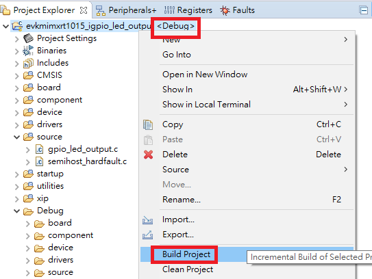

我发现我跟你的.s19档案,有相当的差异

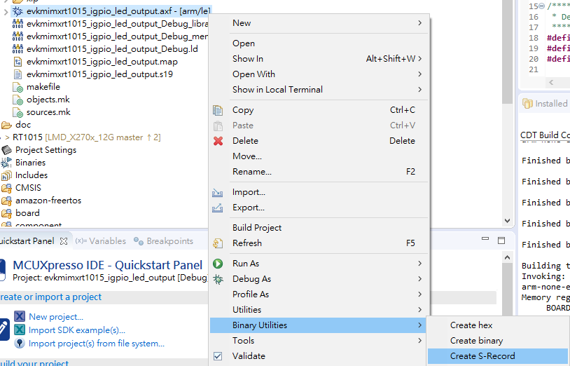

我的步骤是
1.
2.
3.  AXF --> S-Record
我的步骤正确吗?
还是说要使用Release Build?
Ken

Hi Ken Su,
  上午好,非常高兴听到你至少能用我的文件工作了。
  我这边使用的是debug模式,不是release模式。
  你说有差异,具体差异是什么?

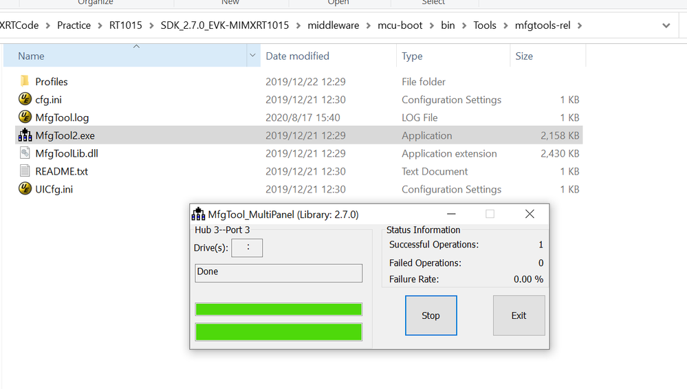

976 Views
kensu
Contributor V
Hi Kerry
Good news!
我使用你的
烧进去我的EVK
Image跑起来了!
我也会先确认这个部分
Ken

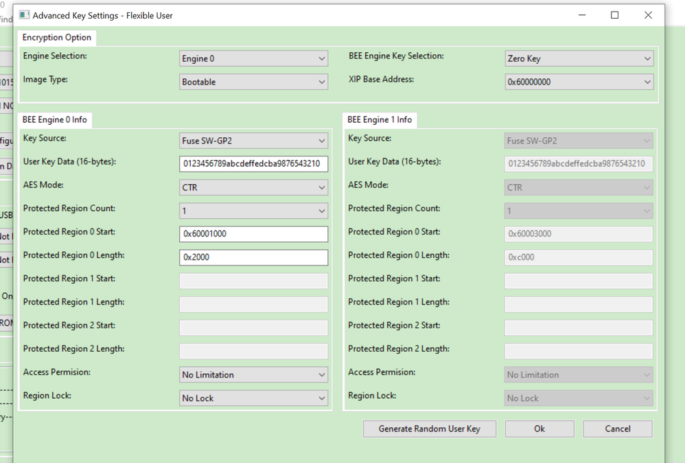

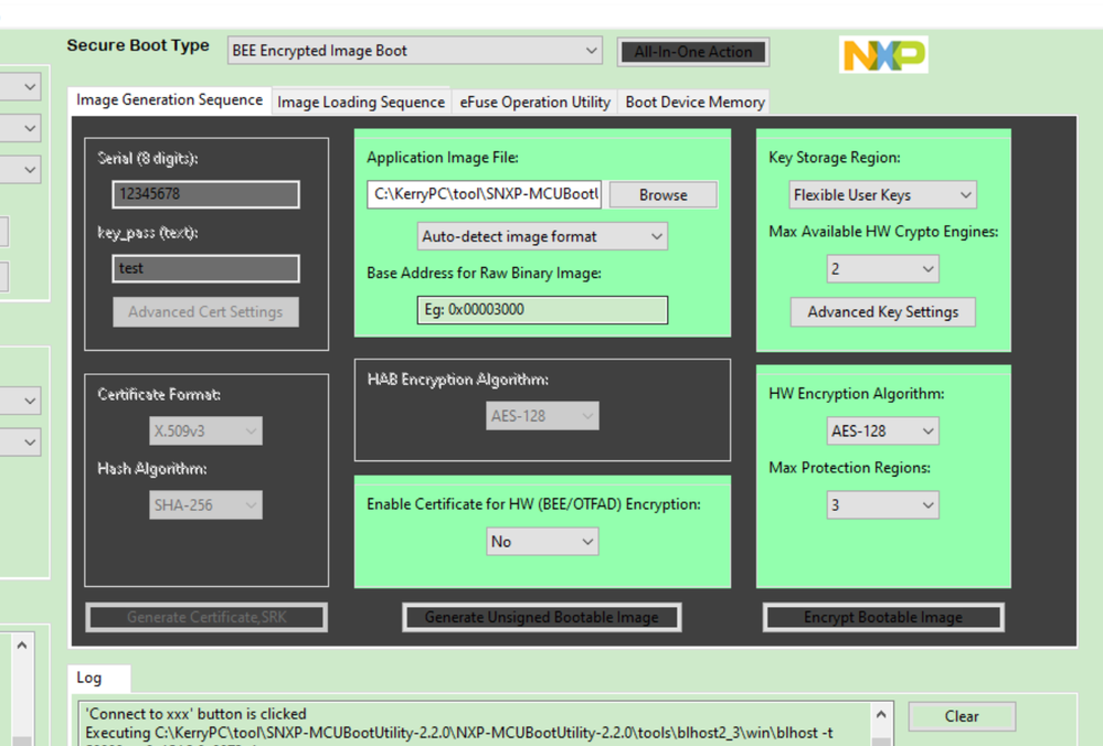

1.  关于我上面MCUBootUtility的配置,对应的image_enc 的命令如下:
C:\KerryPC\tool\SNXP-MCUBootUtility-2.2.0\NXP-MCUBootUtility-2.2.0\tools\image_enc2\win>"C:\KerryPC\tool\SNXP-MCUBootUtility-2.2.0\NXP-MCUBootUtility-2.2.0\tools\image_enc2\win\image_enc.exe" hw_eng=bee ifile="C:\KerryPC\tool\SNXP-MCUBootUtility-2.2.0\NXP-MCUBootUtility-2.2.0\gen\bootable_image\ivt_evkmimxrt1015_iled_blinky_0x60002000_unsigned.bin" ofile="C:\KerryPC\tool\SNXP-MCUBootUtility-2.2.0\NXP-MCUBootUtility-2.2.0\gen\bootable_image\ivt_evkmimxrt1015_iled_blinky_0x60002000_unsigned_bee_encrypted.bin" base_addr=0x60000000 region0_key=0123456789abcdeffedcba9876543210 region0_arg=1,[0x60001000,0x2000,0] region0_lock=0 use_zero_key=1 is_boot_image=1
和你ppt里面有些区别,主要使用的BEE engine key是zero key,你PPT命令不配置,则默认为radom key
2. 关于你那边SB文件最后MFGTool的问题
   你最大的问题是直接使用了program_flexspinor_image_hyperflash_encrypt_sw_gp2.bd,这个是RT1050结合hyperflash的bd文件,而你如果使用的是MIMXRT1015-EVK 板子,实际上你的板载flash芯片是QSPI 芯片:adesto AT25SFxxxA芯片,你需要使用的bd文件内容如下:
sources {
myBinFile = extern (0);
section (0) {
load 0xc0000007 > 0x20202000;
load 0x0 > 0x20202004;
enable flexspinor 0x20202000;
erase 0x60000000..0x60005000;
load 0xf000000f > 0x20203000;
enable flexspinor 0x20203000;
load myBinFile > 0x60000400;
如果使用的是单引擎,engine0的话,那么fuse那边只需要烧 BEE_KEY0_SEL
load fuse 0x00003000 > 0x6;
然后烧写SW_GP2还可以维持之前的:
# program SW_GP2
load fuse 0x76543210 > 0x29;
load fuse 0xfedcba98 > 0x2a;
load fuse 0x89abcdef > 0x2b;
load fuse 0x01234567 > 0x2c;
当然,如果已经烧写了fuse,后面再改变firmware的时候,bd文件里面可以去掉烧fuse的内容,直接烧写文件就可以了。
你那边目前的最大问题应该是.bd文件内容不对,是针对Hyper flash的,所以生成的文件是不能够烧录到你的qspi flash的。
我建议你用我这边的bd文件内容再试下。

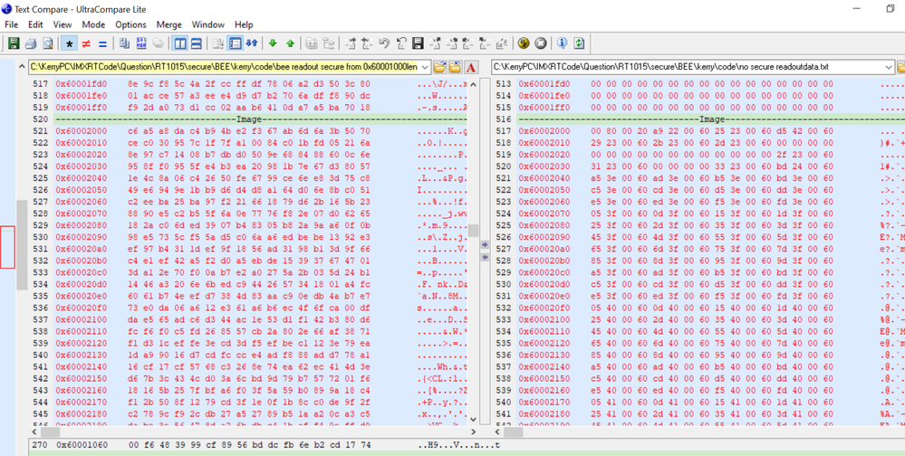

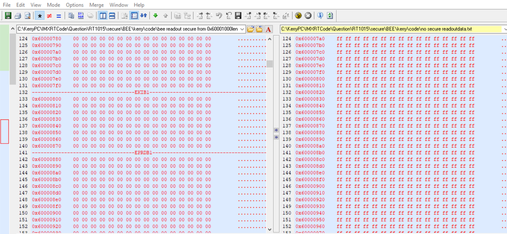

你也可以用我附件里面的sb去烧录看看, 我这边MFGtool烧录结果:

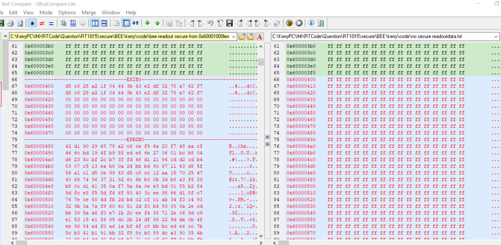

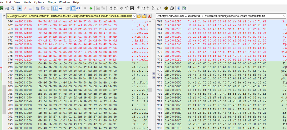

我的文件,加密区域起始地址是:0X60001000,长度是0X2000。
我也给出我的未加密app的原文件,你可以发现,如果烧录了我 的SB文件,再读出image,你会发现,0X60001000-0X60002FFF是密文,0X60003000开始就是明文了。

后来我的FAE建议我将load Hyperflash部分改成
load 0xC0000006 > 0x2000
MFGTool就可以将.sb 档案成功烧录

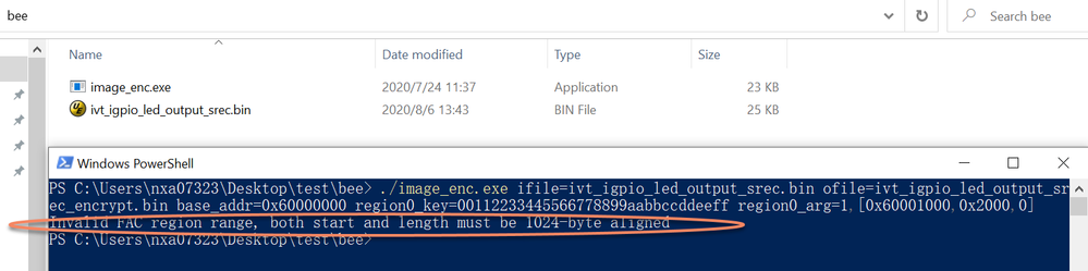

  我看到你之前上传的文件中,是可以用image_enc.exe, 你在做这个命令生成BEE加密文件的时候是否遇到过问题?
./image_enc.exe ifile=ivt_igpio_led_output_srec.bin ofile=ivt_igpio_led_output_srec_encrypt.bin base_addr=0x60000000 region0_key=00112233445566778899aabbccddeeff region0_arg=1,[0x60001000,0x2000,0]
Invalid FAC region range, both start and length must be 1024-byte aligned
 我这边发现总是出现invalid FAC region range的问题。
然后我用你的image_enc.exe, 还有你的源文件ivt_igpio_led_output_srec.bin,还是会出现这个问题:
麻烦你那边看看,你是怎么解决这个问题的?
我现在图片中两个文件都是你的文件。
要么难道是不能用powershell,必须要用和你一样的bat文件吗?
我现在自己这边单独用powershell也是会出现这个问题。

kerryzhou
这个问题最后确认下来是powershell问题,用cmd就不会出这个问题了。
我认为这边是有问题的
 回答:
     关于.bd section(0),其实这些你都不需要额外的去关心,因为后续MFGTool会自动根据i生成好的sb文件直接去调用对应的接口,这些最终都会通过blhost去直接操作RT芯片,你不需要额外操作,工具会去做了。
关于你对I think the boot_image.sb is the boot_image_encrypt.sb file.这个问题,其实这个是由MFGtool里面的脚本决定。
你打开:SDK_2.8.0_EVK-MIMXRT1015\middleware\mcu-boot\bin\Tools\mfgtools-rel\Profiles\MXRT1015\OS Firmware\ucl2.xml
其实就是你的文件名要和你.xml里面的.sb名字一样就可以了。
当然你选择的是name="MXRT1015-DevBoot" ,那么你就需要改name="MXRT1015-DevBoot" 下面的.sb名字,或者你直接把你的app sb的名称直接改成boot_image.sb,这样就不需要改这个.xml了。

疑问一:
这个部分我了解了,其实MfgTool的ucl2.xml都编好了,只要改name就会对应不同的流程。
name改成MXRT102x-DevBoot后就会对应到有receive-sb-file的command
疑问二:

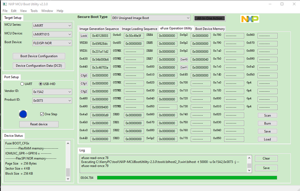

我想问下,你那边现在操作的RT芯片是你之前跑过MCUBootUtility tool,烧了HAB close的片子吗?
对了, 你那边后来有没有继续用MCUBootUtility tool工具烧写呢?而是直接想用这个MFGtool去烧,对吗?
我建议你可以进入serial download模式,然后使用MCUBootUtility工具,连接下,看看是否还能连接?如果能连接成功了,你可以把你的fuse map读出来,然后分享出来给我看看。
你那边测试的板子是我们官方的MIMXRT1015-EVK吗?

我手边有两片NXP官方的RT1015 EVK,还有我们自己案子用的板子,上面也是RT1015。
我的HAB应该是open状态,请确认我的efuse
efuse的读取我附上我自己用blhost读跟用MCUBootUtility scan结果。
我目前只使用MFGtool并没有再使用MCUBootUtility
等你有空的时候再帮我确认
Blhost read:
E:\WORK\Doc\datasheet\vendor\NXP\i.MaxRT\Application\FlashUpgrade\1015\USB_UART_Download_Script>blhost.exe -t 50000 -u 0x15A2,0x0073 -- efuse-read-once 0
Inject command 'efuse-read-once'
Response status = 0 (0x0) Success.
Response word 1 = 4 (0x4)
Response word 2 = 1085440003 (0x40b28003)
E:\WORK\Doc\datasheet\vendor\NXP\i.MaxRT\Application\FlashUpgrade\1015\USB_UART_Download_Script>blhost.exe -t 50000 -u 0x15A2,0x0073 -- efuse-read-once 1
Response word 2 = 1675818370 (0x63e2f582)
E:\WORK\Doc\datasheet\vendor\NXP\i.MaxRT\Application\FlashUpgrade\1015\USB_UART_Download_Script>blhost.exe -t 50000 -u 0x15A2,0x0073 -- efuse-read-once 2
Response word 2 = 189186514 (0xb46c1d2)
E:\WORK\Doc\datasheet\vendor\NXP\i.MaxRT\Application\FlashUpgrade\1015\USB_UART_Download_Script>blhost.exe -t 50000 -u 0x15A2,0x0073 -- efuse-read-once 3
Response word 2 = 1420820724 (0x54b000f4)
E:\WORK\Doc\datasheet\vendor\NXP\i.MaxRT\Application\FlashUpgrade\1015\USB_UART_Download_Script>blhost.exe -t 50000 -u 0x15A2,0x0073 -- efuse-read-once 4
Response word 2 = 1011249210 (0x3c46703a)
E:\WORK\Doc\datasheet\vendor\NXP\i.MaxRT\Application\FlashUpgrade\1015\USB_UART_Download_Script>blhost.exe -t 50000 -u 0x15A2,0x0073 -- efuse-read-once 5
Response word 2 = 0 (0x0)
E:\WORK\Doc\datasheet\vendor\NXP\i.MaxRT\Application\FlashUpgrade\1015\USB_UART_Download_Script>blhost.exe -t 50000 -u 0x15A2,0x0073 -- efuse-read-once 6
E:\WORK\Doc\datasheet\vendor\NXP\i.MaxRT\Application\FlashUpgrade\1015\USB_UART_Download_Script>blhost.exe -t 50000 -u 0x15A2,0x0073 -- efuse-read-once 7
E:\WORK\Doc\datasheet\vendor\NXP\i.MaxRT\Application\FlashUpgrade\1015\USB_UART_Download_Script>blhost.exe -t 50000 -u 0x15A2,0x0073 -- efuse-read-once 8
E:\WORK\Doc\datasheet\vendor\NXP\i.MaxRT\Application\FlashUpgrade\1015\USB_UART_Download_Script>blhost.exe -t 50000 -u 0x15A2,0x0073 -- efuse-read-once 9
Response word 2 = 41984 (0xa400)
E:\WORK\Doc\datasheet\vendor\NXP\i.MaxRT\Application\FlashUpgrade\1015\USB_UART_Download_Script>blhost.exe -t 50000 -u 0x15A2,0x0073 -- efuse-read-once 24
E:\WORK\Doc\datasheet\vendor\NXP\i.MaxRT\Application\FlashUpgrade\1015\USB_UART_Download_Script>blhost.exe -t 50000 -u 0x15A2,0x0073 -- efuse-read-once 25
E:\WORK\Doc\datasheet\vendor\NXP\i.MaxRT\Application\FlashUpgrade\1015\USB_UART_Download_Script>blhost.exe -t 50000 -u 0x15A2,0x0073 -- efuse-read-once 26
E:\WORK\Doc\datasheet\vendor\NXP\i.MaxRT\Application\FlashUpgrade\1015\USB_UART_Download_Script>blhost.exe -t 50000 -u 0x15A2,0x0073 -- efuse-read-once 27
E:\WORK\Doc\datasheet\vendor\NXP\i.MaxRT\Application\FlashUpgrade\1015\USB_UART_Download_Script>blhost.exe -t 50000 -u 0x15A2,0x0073 -- efuse-read-once 28
E:\WORK\Doc\datasheet\vendor\NXP\i.MaxRT\Application\FlashUpgrade\1015\USB_UART_Download_Script>blhost.exe -t 50000 -u 0x15A2,0x0073 -- efuse-read-once 29

  今天我测试了下MIMXRT1015-EVK的情况,不过我还没用命令的模式,我暂时是用MCUBootUtility工具测试,这边BEE不使能HAB加密的方式,我已经测试成功,这是我这边的配置以及测试情况。
fuse map, 初始无加密状态:
fuse map,加密之后的状态:
配置情况:
从加密区域可以知道,从0X60001000开始,长度为0X2000,image之后将会无加密,所以我这边分别把同样的代码做加密烧录和无加密烧录,并且把flash空间地址数据读出来对比。
可以看到BEE加密比无加密的代码多了EKIB0, EPRDB0数据,因为我只是使用了region0加密,没有用region1
可以发现,IVT, boot data区域也是加密了,后面0X60001000到0X60002FFFF加密了,再后面数据就一致了。
