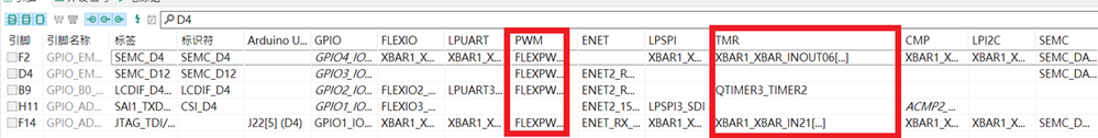

  1. if PWM module is used for the input function , do we select whether an PWM module includes a timer or not ? and what is different on PWM module with /without a timer?
2. do UART have a SWAP SW setting by TX and RX if a wrong connection occurs
=>Answer: If you select the pin as the PWM function, it is not the TMR pin.
As you know, PWM and TMR is totally the different peripheral module.
So, if you select it as the PWM in pinmux, then it is the PWM pin.
2. Do UART have a SWAP SW setting by TX and RX if a wrong connection occurs
=>Answer: UART no SWAP function, you can check the UART pin, TX and RX is not shared, so, you need to make sure HW connection is correct.
