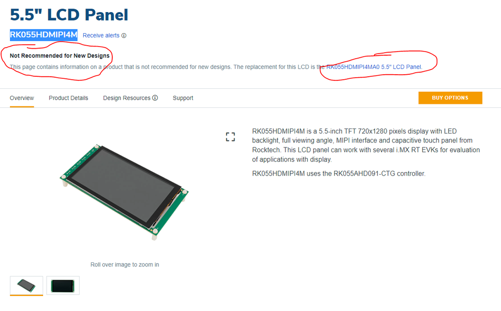

my HW: RT1170-EVK + RK055HDMIPI4M
when I bought the EVK and TFT, they worked well by my MCUXpresso 11.3.0 + SDK 2.9.0 (example code)
some time ago, I upgrade MCUXpresso to 11.5.0 + SDK2.11.1
also I upgraded the DAP firmware from default to LPC-LINK2 CMSIS-DAP V5.361
Now I notice none the LCD example code from SDK 2.11.1 worked. Even I opened the old MCUXpressso 11.3.0 and the old SDK2.9.0. All example codes don't work anymore.
What could happen?
Ocassionally, I found this info by NXP web page:
does it mean, the old RK055HDMIPI4M not supported the the SDK anymore? What is the difference between the old LCD and the new type?

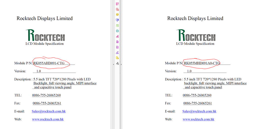

1) Does it mean, the old RK055HDMIPI4M does not support SDK anymore?
-- No, the old SDK should support it.
2) What is the difference between the old LCD and the new type?
-- The controllers of these two LCDs are different, and you can learn the differences by comparing their datasheets, which are downloadable on the NXP website.

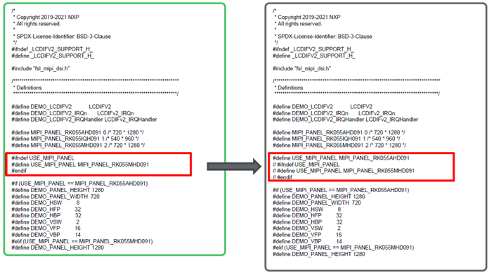

brendonslade
Hi Siwei,
Rocktech discontinued the previous display, so we had no choice but to change. You dont need to by the new display to use any partner or open source graphics libraries; the default LCD in SDK 2.11 is the new version of the Rocktech RK055, so you just need to change the LCD selection from  in the LCD driver header files. For example:
