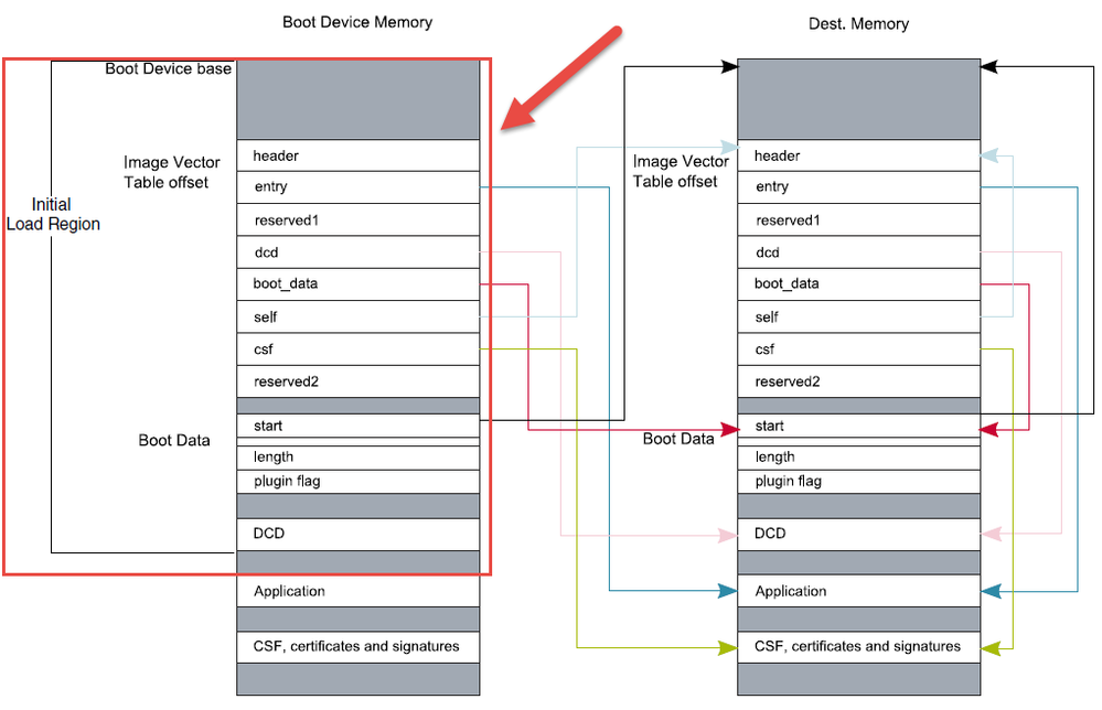

I'm also not sure why the documentation instructs to change the FLASH region from 0x60000000 to 0x60002000.  Is this necessary if XIP_BOOT_HEADER_ENABLE=1 and dcd.bin isn't used?

That post doesn't explain *why* you must set the flash region to 0x60002000...  is it to leave room for the dcd block?

1) That post doesn't explain *why* you must set the flash region to 0x60002000...  is it to leave room for the dcd block?
-- No, it's used to leave room for the area be highlighted by the red rectangle.
Hope this is clear.
