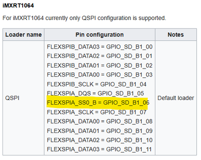

In RT1064 EVK, I was able to program directly into external flash via J-link.
However, I cannot do the same in my custom board.
The difference is that my custom board is using kFLEXSPI_PortB1 instead of kFLEXSPI_PortA1.
Also, dqs pin is not used in my custom board. I had to change clock source as kFLEXSPI_ReadSampleClkLoopbackInternally instead of kFLEXSPI_ReadSampleClkLoopbackFromDqsPad.
I found i.MXRT1060 - SEGGER wiki page that FLEXSPIA_SS0_B is only supported?
https://kb.segger.com/i.MXRT1060
This means my custom board cannot be program/erase directly via J-link because I am using FLEXSPIB_SS0_B = GPIO_SD_B1_04?

Hi @choix361 ,
Thanks for your interest in NXP MIMXRT series!
Yes, the PORTB flash can only be used for IAP. Please kindly check this thread: https://community.nxp.com/t5/i-MX-RT-Crossover-MCUs/IMXRT1062-NOR-Flash-on-FlexSPI-B/m-p/1583452
In addition, this Chinese document goes into more detail on this, which can be a good reference: https://www.cnblogs.com/henjay724/p/12375942.html
