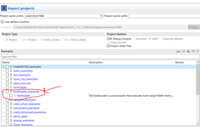

I am using MIMXRT1064 - EVK.
I had imported bootloader_example - Flashloader sdk for reference to my bootloader implementation.
In this sample code, I am not able to use UART drivers and also not able to see debug message in terminal.
Please check and help me with the issue of UART.
Function not working is
After this function executes, not able to see print on terminal.
Also, Can I get any tutorial or document which explains about the activities/steps done in SDKs provided by NXP.
Being new in this field, this can help me understand the SDKs better specially for bootloader.

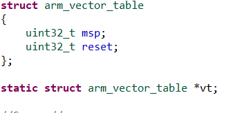

I am facing issue while jumping to application code.
I am using below logic:
But after executing above mentioned code, My code is going to some unknown state.
I need to know if I am doing something wrong?
1. Can some one help me out with this?
2. Is it possible to blink LED or give any indication in RESETISR() code? To know after jump if control is going to RESETISR() or not?

3,814件の閲覧回数
jeremyzhou
In default, the flashloader doesn't support the UART prinf function, it needs to developer to port or modify code.
TIC
