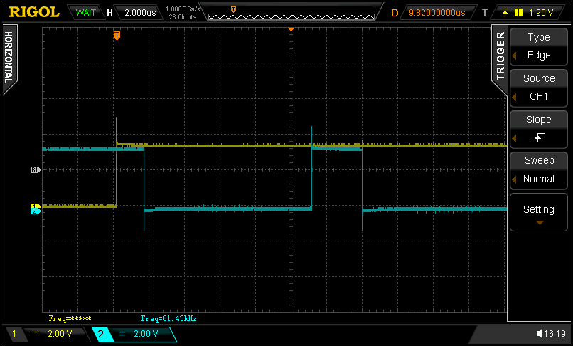

I have a problem with LPSPI (i.MXRT1062). It's about starting the transmission (Master).
Starting PSC + CLOCK begins after ~ 2 us after writing data  to registry (LPSPI->TDR = data or TCR.TXMSK = 1). Is this normal behavior?
On the picture: TDR is updated with the falling edge of the yellow signal. Clock starts 2u later.

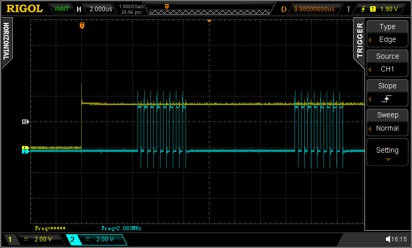

arnipol
Time Tlead (3)  I can decrease to few nanoseconds.
The problem is to decrease time between command putting data to SPI and  SPI_PCS.
See below on picture1 - the red 1.8us. I don't know why SPI starting sendig data so late.
Picture2 -  blue line - PCS
                                      LPSPI_WriteData(EXAMPLE_LPSPI_MASTER_BASEADDR, masterTxData[masterTxCount]);
                  yellow line ->  GPIO_PinWrite(BOARD_INITPINS_CONVST1_GPIO, BOARD_INITPINS_CONVST1_PIN, 1); // yeallow signal

arnipol
The clocks are set correctly, but I finally found a problem. Because I want only read the data from SPI,  i iniciate transmission  by setting the TCR.TXMSK bit = 1. Data is not loaded into the FIFO and the clock starts almost immediately (~ 300ns). Putting data to LPSPI-> TDR causes a much longer delay.
The second problem was delay of port interruption in wich I started the spi clock.
 Although the interruption had the highest priority, the delay of two microseconds still occurred.
The problem was cased by debug console, function DbgConsole_TryGetchar(in main loop)    which blocks all interruptions  by ~2us. Is' it necesery to blocked all interruption? I understand that it protects it's own  resources but sometimes causes the other problems (like in my case).
Anyway, thank You for your help.

arnipol
The yellow signal comes from the ADC converter and triggers the interruption. Inside the interruption, the lpspi clock is initialized to receive data for the next int.
I have checked nxp sample. A little changes i've made are: increase clock to 20Mhz  and insert the <pin triger>
/*Fill up the TX data in FIFO */
while ((LPSPI_GetTxFifoCount(EXAMPLE_LPSPI_MASTER_BASEADDR) < g_masterFifoSize) &&
(masterTxCount - masterRxCount < g_masterFifoSize))
/*Write the word to TX register*/
++masterTxCount;
Time between between LPSPI_WriteData and LPSPI_CS is about 1.8 us. Is't possible to decrease it?
Clock start's more late,  but this is due to wrong calculatin of delay (in SDK 2.7)
