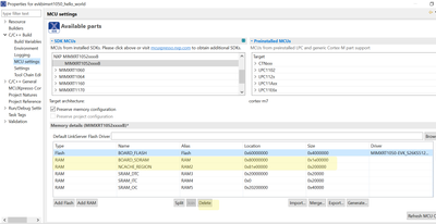

Hi all,
MXRT1050\1052
I'm sorry if this question was asked before, couldn't find the answer .
What should be set in the SDK to avoid using external RAM?
Adi
タグ(3)
2,353件の閲覧回数
kerryzhou

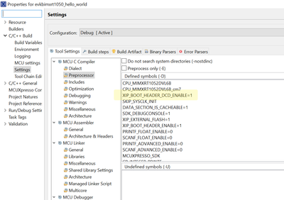

Hi @adi2Intel ,
   If you don't want to use the external SDRAM, and you are using the SDK code for RT1050\2, it is very easy, just set:
XIP_BOOT_HEADER_DCD_ENABLE=0
And delete the SDRAM memory from 0X80000000
Wish it helps you!
If you still have questions about it, please kindly let me know.
Kerry
