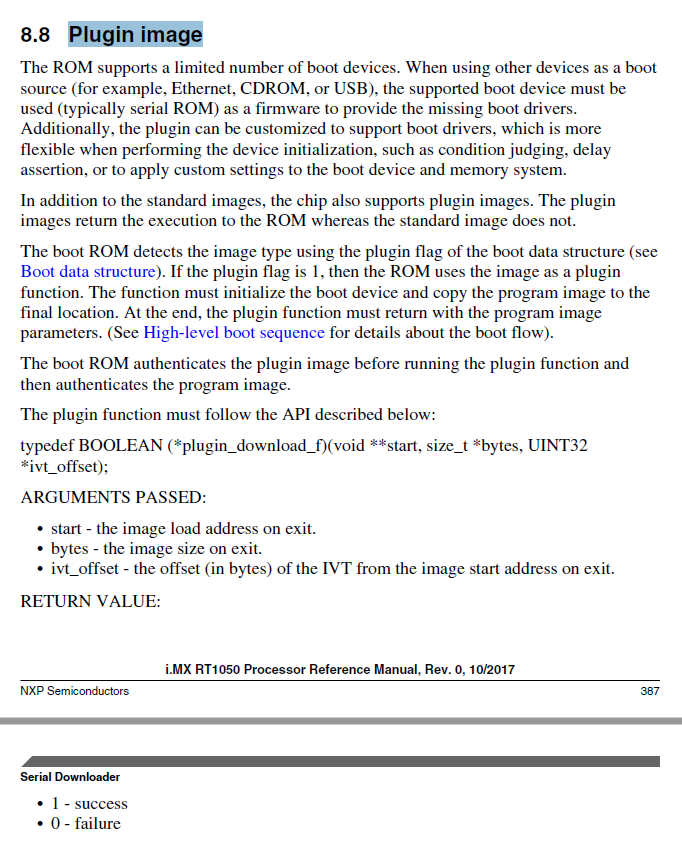

I'm having trouble running a Plugin Image on imxrt1050. I've created a small program which I can run in XIP mode, however when I set the PLUGIN_FLAG macro to 1 in "fsl_flexspi_nor_boot.h" file it fails to boot.
Why would this fail?

diogocacador
Thank you Kerry Zhou for the answer,
In summary I'd like to create a bootloader that is able to update an application image setup to run in Hyperflash in XIP mode.
In my understanding, if this bootloader where to be setup to run in XIP mode from the Hyperflash it would not be able to write a new application image into the Hyperflash.
Therefore I thought of running the bootloader from RAM, which would do some checks and overwrite the application image in hyperflash (if new image were available). Then the bootloader would return from main (as it is a plugin image) with the necessary information for the boot ROM to start the application image from hyperflash in XIP mode.
This is to enable over-the-air updates.
What's your thoughts?

diogocacador
Hello Takashi,
Thank you for the reply.
> I do not know what "plugin image" means, so sorry if I said strange things.
Bellow is a snippet of the Reference Manual for i.MXRT1050 regarding plugin images. I believe it essentially allows you to return from the "main" function of the application back into NXP's ROM Bootloader with the necessary information to boot an application again. It sounds like this would allow my own secondary bootloader to launch my application running in XIP mode from hyperflash instead of having to load it into RAM.
What do you think about this?
I'll have a look at your sample project as a backup plan to the "plugin image" scenario, because at the moment I don't have enough RAM to fit my application code as well as data requirements. That's why I'm really trying to find a way for the secondary bootloader (running from RAM) to launch the application, which would run from hyperflash in XIP mode.
Any thoughts on this?
Diogo

diogocacador
Thank you Takashi,
The source file you pointed at helped solve may problem.
It comes down to the "Image Entry Function" address in the "image_vector_table" defined in file "fsl_flexspi_nor_boot.c" of sdk (usually in "xip" folder) being set to the address of the Vector Table instead of the entry function (usually "main").
By changing that and prototyping main function according to Plugin Image requirements the image now loads.
Hope this helps anyone else trying to use the plugin image mechanism.
Diogo
