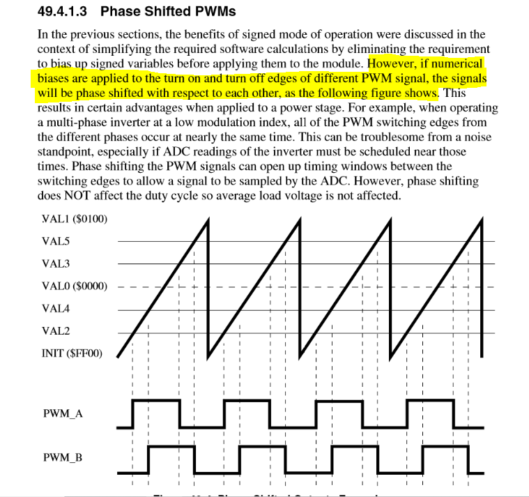

The reference manual says
"If numerical biases are applied to the turn on and turn off edges of different PWM signal, the signals will be phase shifted with respect to each other"
What does Numerical Biases mean ?
Please guide me with the procedure for phase shifting .

Is there any code that is existing , that explains the phase shifted pwms for imxrt 1020 ?
Unfortunately, we don't have any example code for this.
Is there any register in the IMXRT 1020 , with which we can configure phase shift ?
No, there isn't any register on the eFlexPWM module that you can configure to achieve this.
But i need to configure these 5 PWMs with a phase shift of 72 degrees between them , How do it do it ?
I found the following community document where one of my co-workers explains how to achieve this for an LPC. Although the module that he's using it's from the LPC family the same concepts apply for the RT eFlexPWM module. Generating phase-shift PWM signal with SCTimer/PWM module
