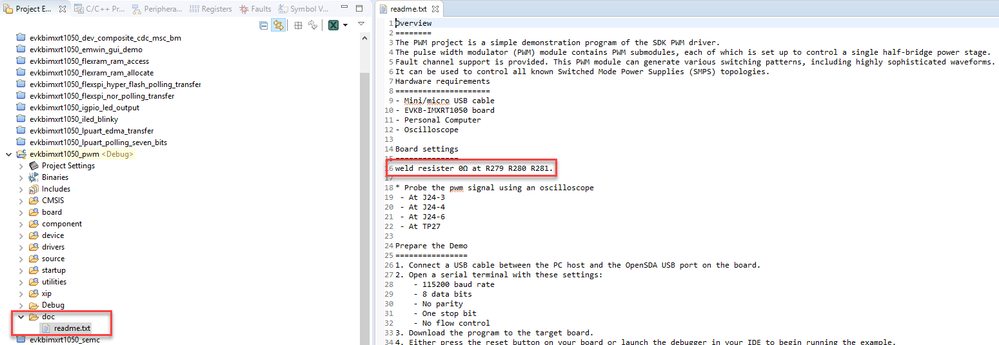

Hello Takis Zourntos,
Regarding soldering in the 0-Ohm resistors, this information is stated in the readme file of the example. This file comes in all the examples of the SDK and it states all the steps that you need to follow to run successfully the projects.

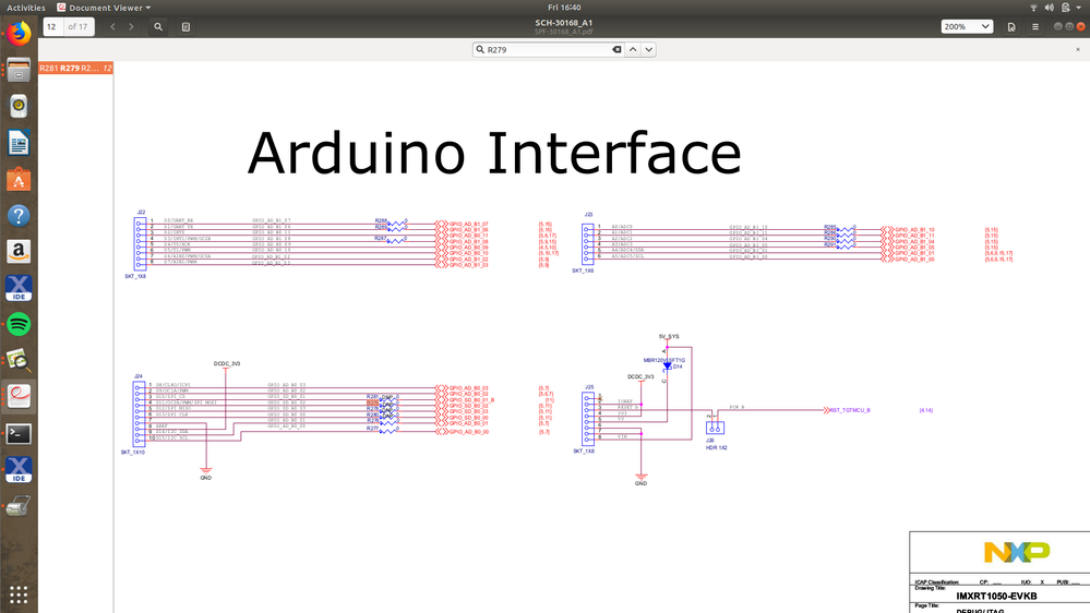

emergentist
After soldering in the 0-Ohm resistors for R279, R280, R281, etc., I have gotten the pwm.c SDK example working. I can see the waveforms on my oscilloscope.

Hi Victor,
Thanks for your input. Yes, I found the readme file somewhat by accident! :smileyhappy: It was a bit tucked away under the docs folder of the project in MCUXpresso IDE.

emergentist
