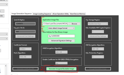

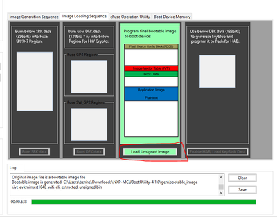

I am now able to debug again. Yay! To get the debugging working again, I built the evkmimxrt1040_wifi_cli example project and flashed with the NXP MCU Boot Utility (maybe other projects will work, but I tried hello world and it didn't work). After manually flashing the wifi cli project I have been able to flash and debug the hello world example again. I haven't been able to make it break again (I'll report here when/how I do).
Steps
1: Build evkmimxrt1040_wifi_cli example project (listed in the wifi_examples group).
2: Open NXP MCU Boot Utility, connect to your MCU (not explained here).
3: Select the Application Image File you just built (file extension .axf). The location of mine is below, but yours will be elsewhere based on your MCUXpress workspace location.
C:\Users\user\Documents\MCUXpressoIDE_11.7.0_9198\workspace\evkmimxrt1040_wifi_cli\Debug\evkmimxrt1040_wifi_cli.axf.
Then choose "Generate Unsigned Bootable Image".
4: Finally, choose "Load Unsigned Image" on the page that appears after the image generation is complete. This takes a few minutes to flash...
Once flashed, I was able to reset my MCU, open MCUXpresso and start a debug session. Let me know if this works for you. I am still unsure why this worked. Any extra insight would be appreciated.

So, having found a Windows machine to work on I've downloaded the MCU Boot Utility.
I get an error when clicking "Load Unsigned Image":
"Please configure boot device via Flashloader first!"
I have no idea what it wants me to do - any hints?

Not sure. Some things to double check (may all be obvious to you & already done, but just to be sure):
  • Connect to the main MCU's USB port instead of the OpenDAP
  • Configure the MCU for Serial Boot via the two Boot Mode switches on SW4 (0, 1 instead of the default 1, 0)
  • Reset the MCU
  • Check the Device Manager for two "vendor specified" USB devices
  • Run the Boot Utility, it should automatically find the first of the two USB devices
  • In the Boot Utility, connect to the board, this should download the necessary flashloader into the MCU's RAM
6,223 Views
expertsleepers
None of this is obvious! I'm on day 2 of NXP MCUs and so far everything's quite bewildering. I'm finding the documentation great on detail but very lacking in high level overviews.
Anyway, taking all of what you said on board I've now managed to flash it with the Boot Utility and I'm finally able to debug again! Which is great. Many thanks.
