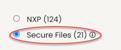

Hi @etronic_arg ,
Yes, please refer to the following for details.
and you have to access it via the secure file.
Please kindly refer to https://www.nxp.com.cn/docs/en/user-guide/nxp-secure-access-rights-registration.pdf for more details.
Kan

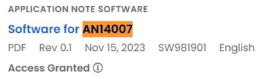

etronic_arg
Hello Kan,
I haven't been able to find the download link you refer to on the NXP website.
Would you mind sending me the link where is the AN14007SW?
Pablo

Kan_Li
Hi @etronic_arg ,
This package can only be requested via secure file, please request a higher access right for it. Please kindly refer to https://www.nxp.com.cn/docs/en/user-guide/nxp-secure-access-rights-registration.pdf for details.
Please kindly sigh NDA online according to the following:
Any further access issue , please contact our doc store team via support.docstore@nxp.com with your NDA file.
