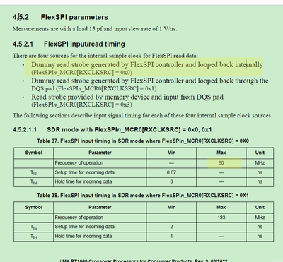

2,212件の閲覧回数
kerryzhou
Hi @filo96 ,
  Thanks for your updated information.
  From your log, it is report the flashloader program issues:
ProgramPage (0x64000000, 0x20005770, 0x4000) status 0x1 - driver reported driver error - EXTSPIJ driver rc 7001 (0x1B59)

  I know your root issues now, just be caused by your DQS is used.
  To this situation, you need to set the flashloader flexspi mode to the loop back internally:
FlexSPIn_MCR0[RXCLKSRC]=0x0, and also need to set the flexspi frequency not lager thank 60Mhz.
  Now, you are using the MCUXPresso, so, you need to generate the new .cfx file.
You can refer to this post:
https://community.nxp.com/t5/i-MX-RT-Knowledge-Base/How-to-create-a-new-Flash-driver-of-the-MCUXPres...
Then, in the flashloader source code modify the frequency to 60Mhz at first, then try it again.
