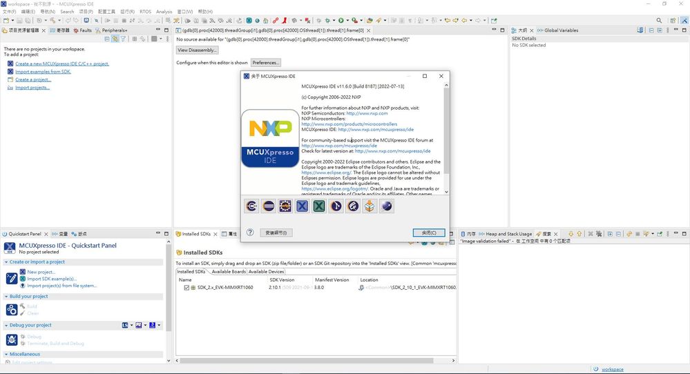

Step1. Install MCUXpresso IDE v11.6.0 and SDK 2.10.1

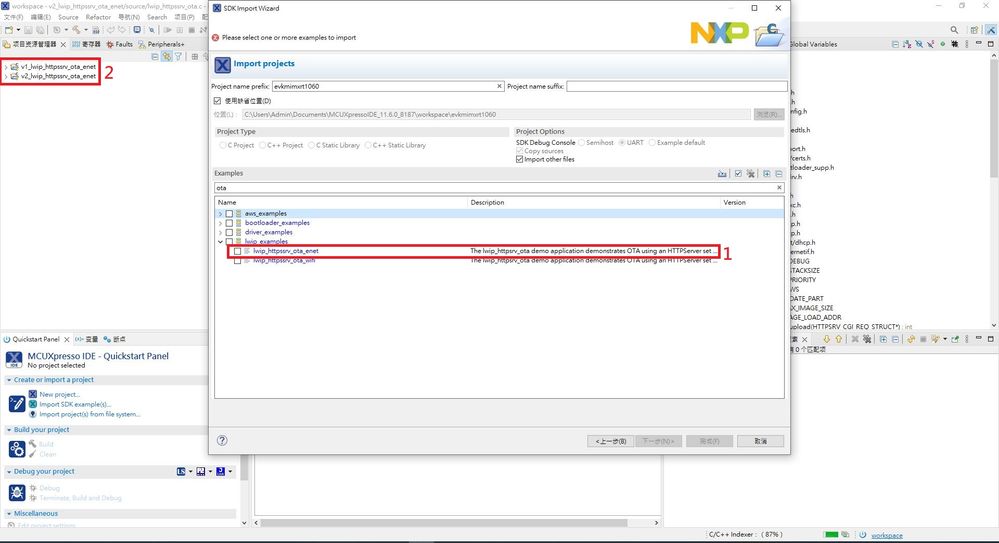

Step2. Import SDK examples "lwip_httpssrv_ota_enet" and named it  "v1_lwip_httpssrv_ota_enet" and "v2_lwip_httpssrv_ota_enet"

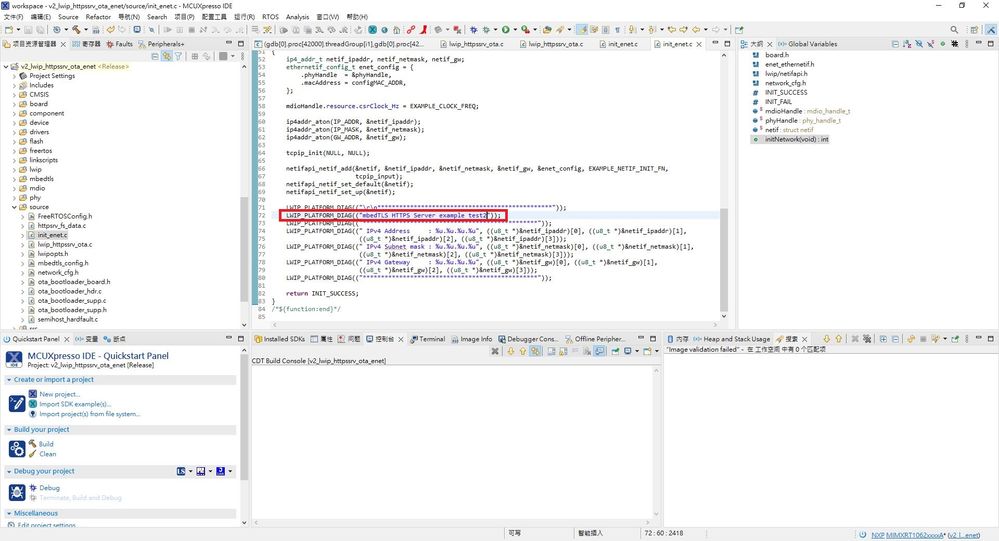

Step3. Modify the print message to identify the different image.
v1_lwip_httpssrv_ota_enet:
v2_lwip_httpssrv_ota_enet:

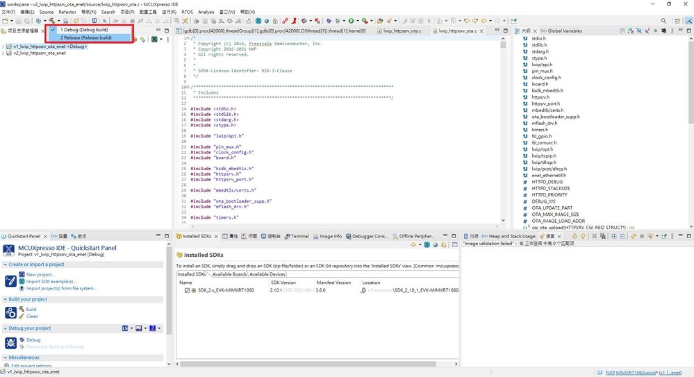

Step4. Release build the "v1_lwip_httpssrv_ota_enet" and "v2_lwip_httpssrv_ota_enet" project

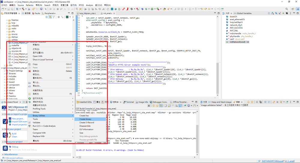

Step 5. Create the binary file of "v1_lwip_httpssrv_ota_enet" and "v2_lwip_httpssrv_ota_enet"

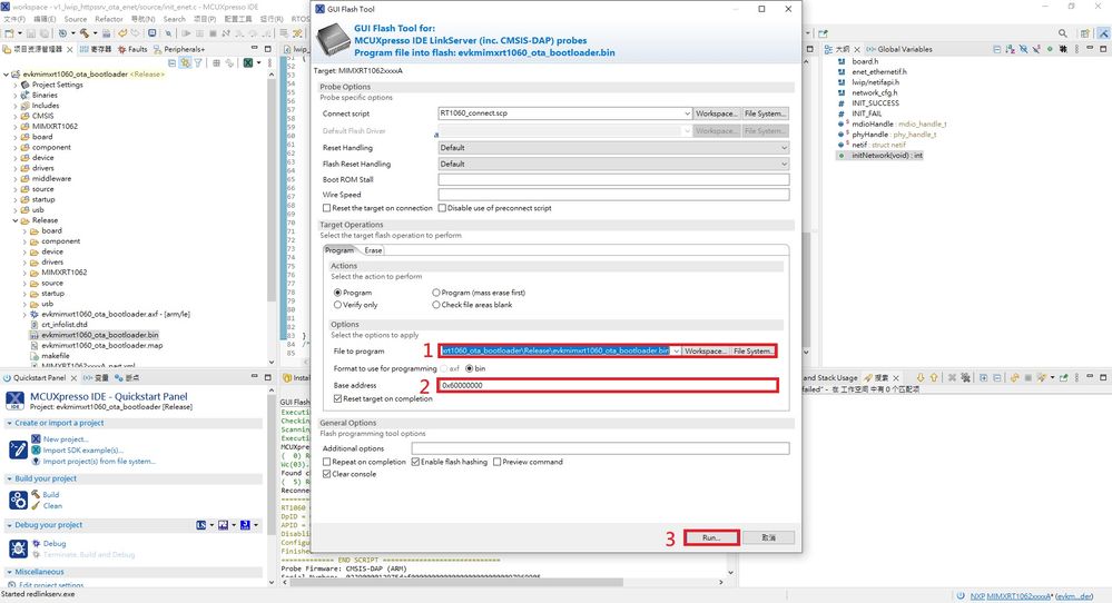

Step 6. Import SDK examples "ota_bootloader", release build and create binary file.
Step 7. Use the GUI flash tool to flash the binary file to RT1060 EVK board.
evkmimxrt1060_ota_bootloader.bin(0x60000000)
v1_lwip_httpssrv_ota_enet.bin(0x60040000)

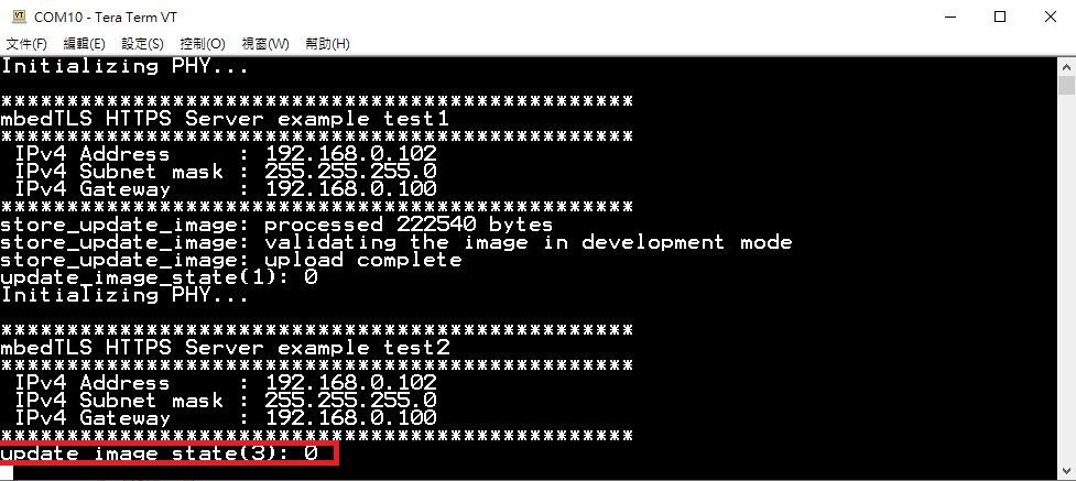

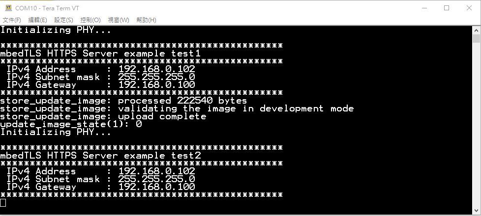

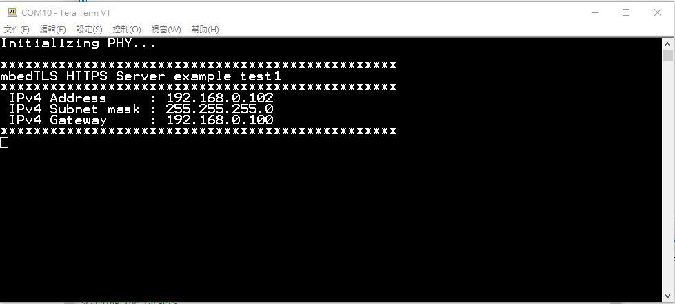

Step 8. Connect RT1060 EVK to COM10 and it will show the following messages.

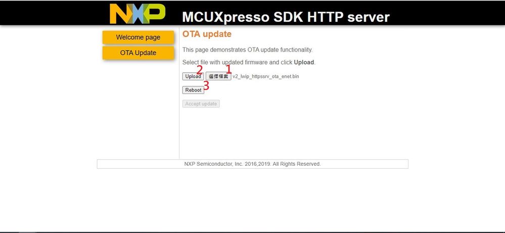

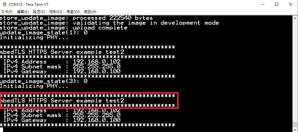

 Step 9. Upload "v2_lwip_httpssrv_ota_enet.bin" by GUI

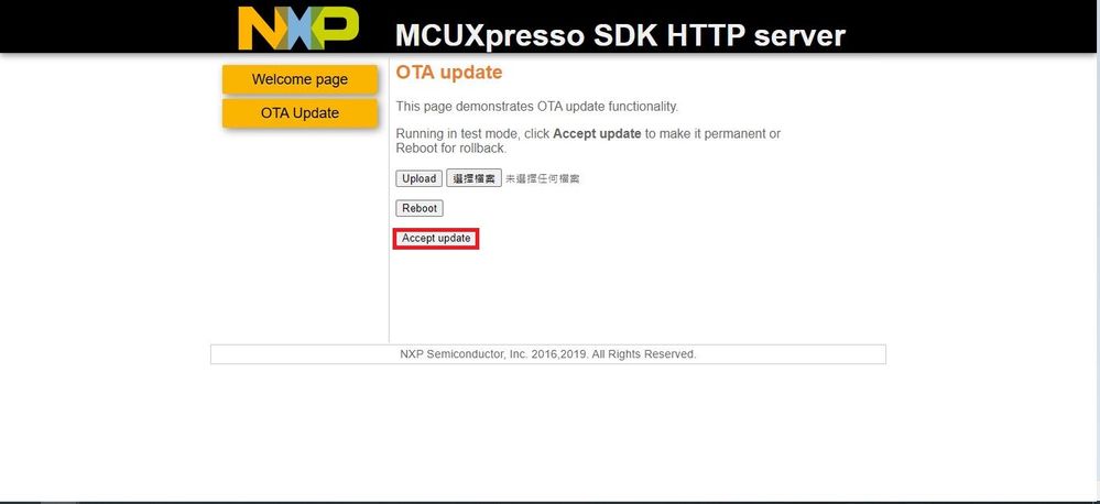

After Reboot, click "Accept Update"
The console will show the "update_image_state(3): 0".
And Reboot again, we will show the application already change to v2 app.
Step 10. But if I would like to upload "v1_lwip_httpssrv_ota_enet.bin" bu web GUI again, it will shown the "Image validation failed".
