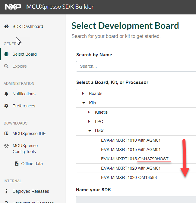

Im using the OM13790 shield to see how difficult it would be to add usb-c pd and negotiation to an existing IMX1050RT project.
I've managed to download the SDK and I see some examples, but is there any documentation anywhere for the SDK?
The example code is a mess of if defs and there's no API information, not even a comment about how to use anything.
The SDK is really just a usb->pd folder with what I guess are PD negotiation drivers. What about configuring DFP/UFP? What about an I2C API?
I hope I'm just not finding the documentation.. because it seems crazy to sell this device as a revolutionary 'plug and play' solution but offer absolutely no documentation.. I'm going to spend forever trying to reverse engineer the examples, it looks like

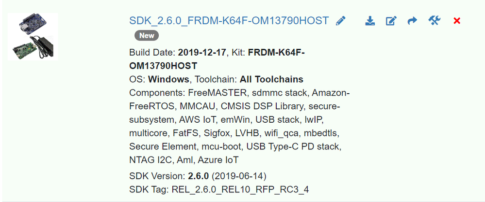

If you download the SDK package with OM13790HOST?

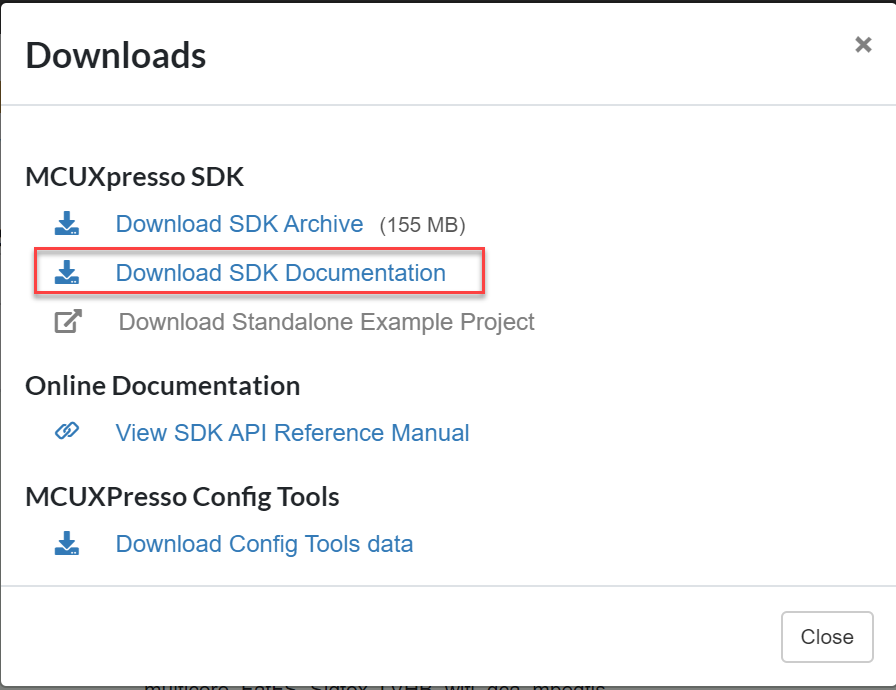

During SDK package download, you can also download related documents:

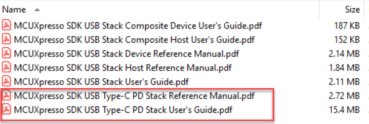

After SDK Documentation dowloaded, you could find two files for MCUXpresso SDK USB Type-C PD Stack:
Wish it helps.
