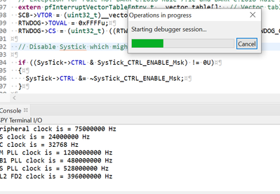

I am using MIMXRT1052xxx6B controller in project with QSPI flash memory from 0x60001000 location.
I am not able to flash on to the board using jlink. It is running last loaded image and now not accepting the new image via jlink.
Please see the terminal it is running but code is not flashing on board.

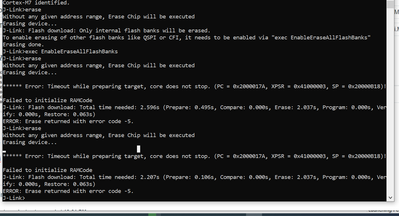

When i am trying to erase using Jlink commander then i am getting
this error so please if any one is having any idea regarding this please let me know the solution for this.
