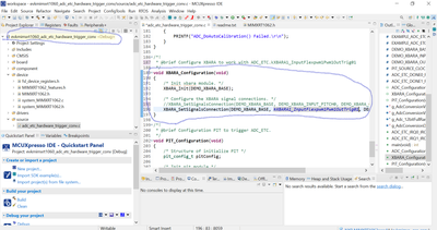

xiangjun_rong
I suppose that you can refer to the ADC example adc_etc_hardware_trigger_conv:
Pls just change the void XBARA_Configuration(void) so that the PWM triggering can trigger ADC
/* Init xbara module. */
XBARA_Init(DEMO_XBARA_BASE);
/* Configure the XBARA signal connections. */
//XBARA_SetSignalsConnection(DEMO_XBARA_BASE, DEMO_XBARA_INPUT_PITCH0, //DEMO_XBARA_OUTPUT_ADC_ETC);
XBARA_SetSignalsConnection(DEMO_XBARA_BASE, kXBARA1_InputFlexpwm1Pwm1OutTrig01, DEMO_XBARA_OUTPUT_ADC_ETC);
while you have to set the PWM trigger register so that the VALUE4 register of PWM can trigger ADC.
Hope it can help you
