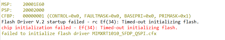

Its new board , 1st time connecting to the PC and trying to run the hello world example. getting error as below,
I also updated the flasher with latest one "lpc4322_mimxrt1010_evk_qspi_if_crc.bin"
Can can one help with this?

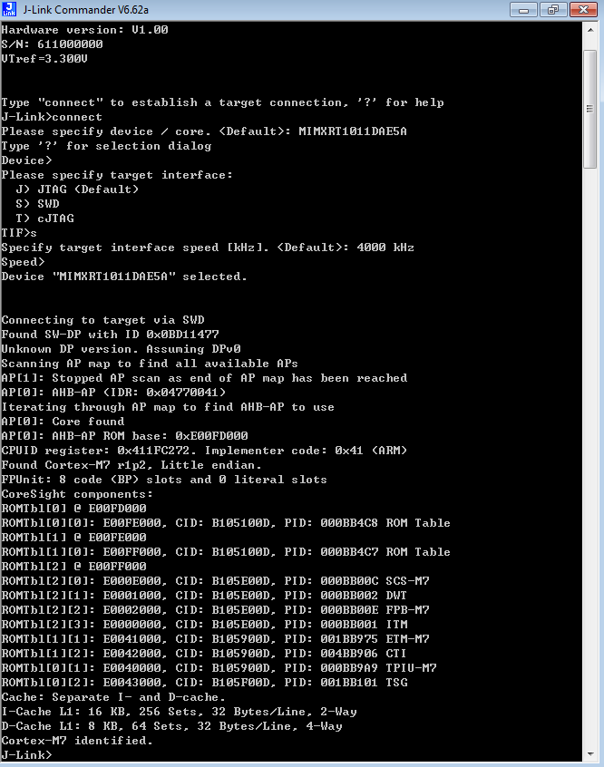

  If your firmware is correct, you will detect :
If you use the external debugger, you still need to choose the correct MIMXRT1015 part number.
External JLINK need to remove J47-J50, this following is my JLINK commander detect result:
Kerry

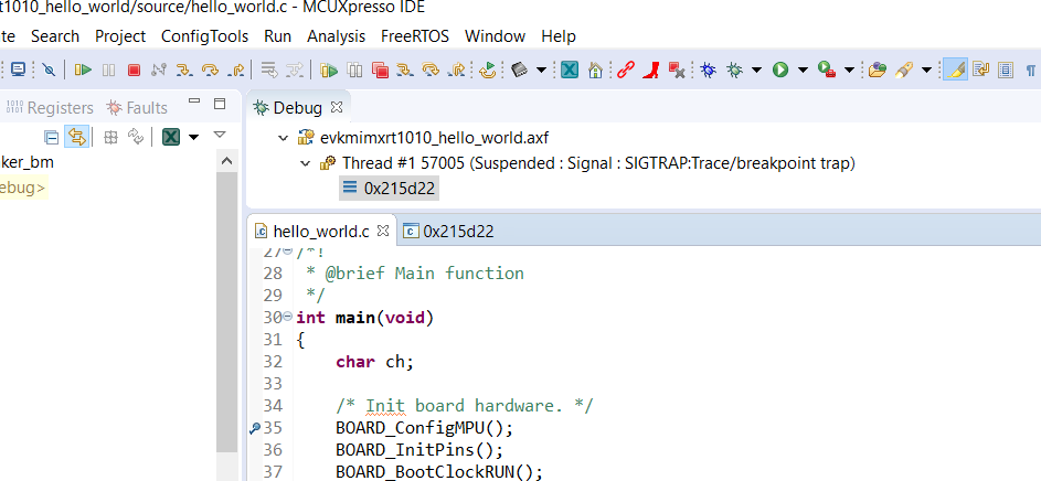

ashokfair
Hi Kerry,
Now i removed the jumpers (J47,J48,J49,J50) not ( correction J61-J64). And Jlink is connected now.
So looks onboard debug chip is dead or did not working.. But still it detect as
Sad part is The hardware user-guide  does not talk about the Jumpers J47 to J50. It shoud be updated.
In editor , what should be the launch configuration looks like for jlink?  i choosed device as "Cortex-M7" instead of MIMXRT1011DAE5A.
Now its not entering into main. Please share the proper lunch configuration

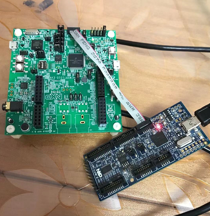

kerryzhou
HiAshok Ra,
  Are you sure you are using the MIMXRT1010-EVK board?
  If yes, you still need to disconnect J61-J64, then connect your external JLINK SWD interface to the j55.
  I have tested it on my side, it works OK.

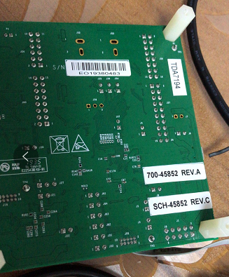

Hi Ashok Ra
  Please let me know your board version, you can find it from the back side in the board, just like my board picture:
SCH-45852 REVC.
 Please give me your board version picture.

ashokfair
Hi Zhou,
My Board versions: 700-38830 REV A, SCH-38830 REV.B
7,986 Views

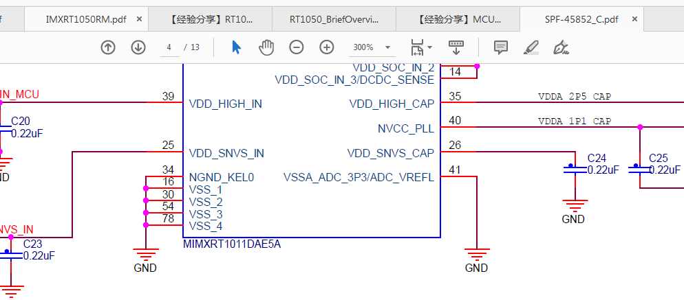

kerryzhou
Hi Ashok Ra,
 Please double check your board name, is it MIMXRT1010-EVK or MIMXRT1015-EVK?
 Because I find my MIMXRT1015-EVK schematic version is SCH-38830 REVB, it seems you have chosen the wrong RT chip device.
  Please double check your board.
Any updated information, please kindly let me know.
Kerry

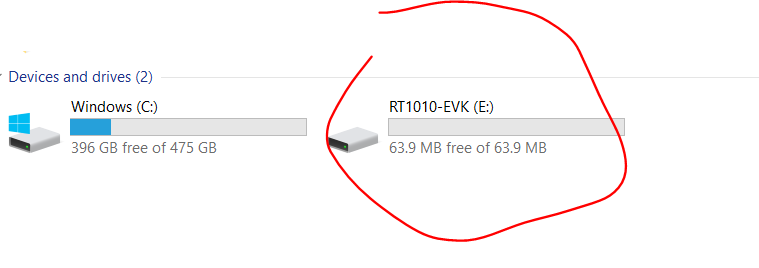

ashokfair
Hi Kerry,
Yes , sorry  for the trouble the board is 1015 not 1010 , but detected as 1010 because i flashed 1010 openSDA?
Ashok r
7,987 Views
kerryzhou
Hi Ashok Ra,
  Thanks for your updated information.
   Yes, you are using the wrong debugger firmware, please download the MIMXRT1015 to your board again.

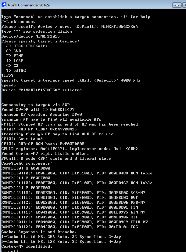

Kerry

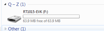

ashokfair
Hi Zhou,
I re-flashed the  Open SDA firmware , then programmed led blink demo everything works fine.
Lets close this thread.

I already tried that option, RT1011 but getting following error.
SW8 -> OFF OFF OFF ON
Any other settings required?

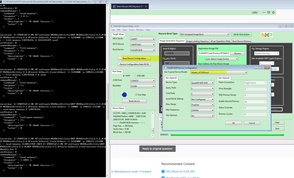

   Please check the following configuration, do you use the adesto_AT25SFxxxA flash?
After you modify the SW8 -> OFF OFF OFF ON, please also press the reset button, then try to connect your board.
Please also check whether your COM8 is really your on board virtual COM port.

Sorry to say this! Im using same Boot configuration and it does not works.. when i click the Flash button .. The LED blinks fast and i could see yellow indication in the Tool, then suddenly RED led stops (board) and indication changed into red color. gets error message

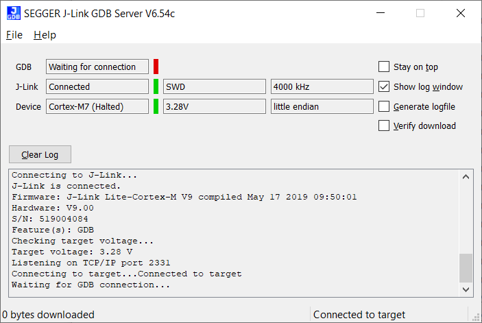

ashokfair
Hi Kerry Zhou,
I tried with Jlink Debugger , connected with Port J55 on board.
Below the response i got. Did not connecting ..

kerryzhou
Hi Ashok Ra,
   If you are using the external JLINK debugger, you also need to disconnect the on board debugger: J61-J64 disconnect.
  Then try it again, can you find the ARM core? If you still can't find the ARM core, it means your hardware have problems. Please also make sure your board is powered on after you use the external debugger.

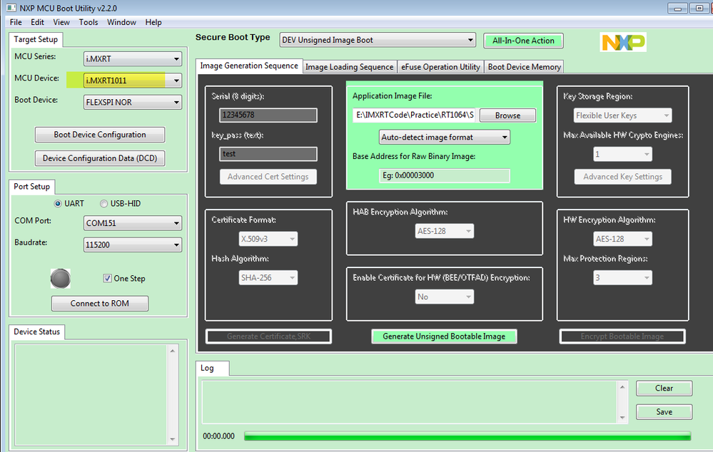

But My board is RT1010,  MCUBootUtility tool does not list my board to connect.
7,990 Views

Hi Ashok Ra ,
   Which IDE you are using?
   Please modify the SW8 to 1:off, 2:off:3:off, 4:on.
   Then use the MCUBootUtility tool:
https://github.com/JayHeng/NXP-MCUBootUtility/archive/v2.2.0.zip
the related user manual is:
   Connect your board through the UART com port, then erase the external flash.
   After the flash is erased, then you can try the IDE connection again.
Please try it.
If you still have questions about it, please kindly let me know.
