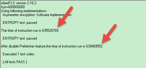

Hi Kamran Farhangi ,
Sorry for reply late.
I do the similar testing as you did (Fig 1), comparing the executing time of mbedtls library function between disabling and enabling AHB Read Prefetch feature circumstances, however, I find the result is versus to your previous result.
I've attached the testing demo, maybe you can give a try.

k_farhangi
Hi jeremyzhou‌,
Sorry for the late reply,
The code that I had mentioned earlier is a part of a bigger project and I can not upload the whole project here. I isolated the part that is related to my question and attached to this reply. You probably need to include the cmake file and possibly change a few thing so that it compiles on your setup. Thank you in advance.

k_farhangi
Thanks, then I guess something else is happening while I'm performing this test, like some thread switching in the background or so, because I run this example inside an RTOS and with a minimized number of background tasks. Now I know that the prefetcher does increase the performance in an example like this.
