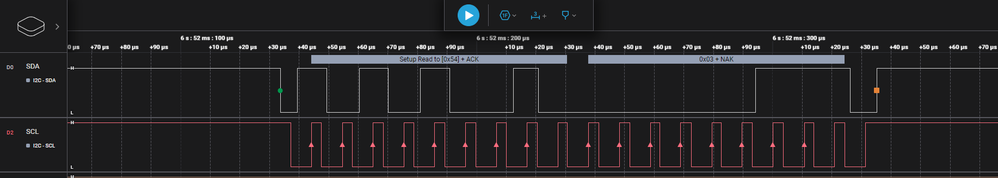

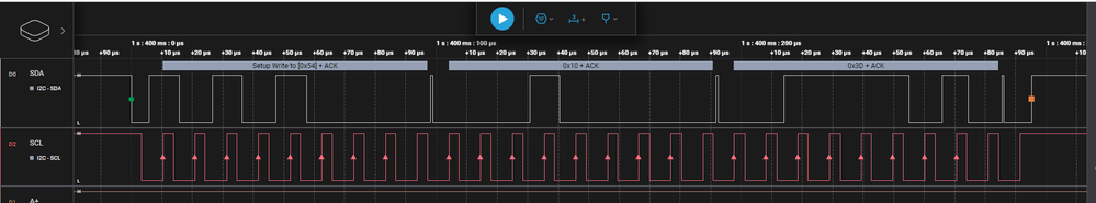

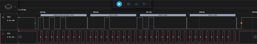

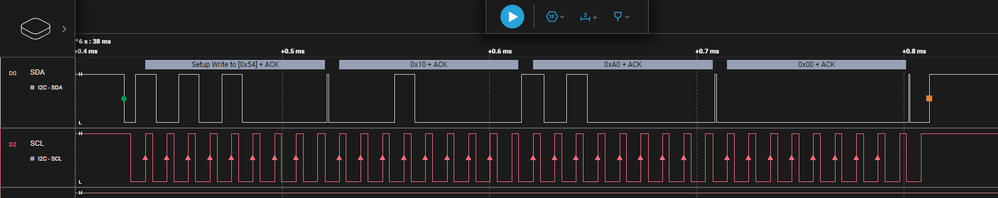

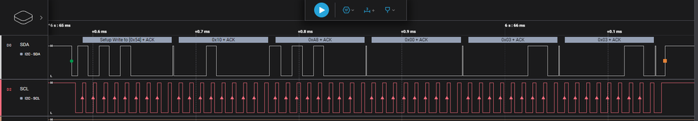

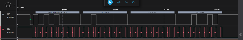

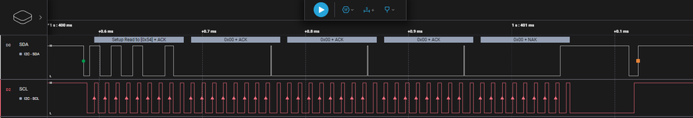

step4_WriteMemory_WriteSRAM_NACK.pngstep1_ReadMemory1_ReadEDConfig_ACK.pngstep1_ReadMemory2_ReadEDConfig_NACK.pngstep1_WriteMemory_ReadEDConfig_ACK.pngstep2_NFC_Detected_ReadRegister1_ReadED_ACK.pngstep2_NFC_Detected_ReadRegister2_ReadED_ACK.pngstep2_ReadRegister1_ReadED_ACK.pngstep2_ReadRegister2_ReadED_NACK.pngstep3_WriteRegister_PrepareForWriteSRAM_ACK_1.pngstep3_WriteRegister_PrepareForWriteSRAM_ACK_2.png
Hi Eduardo,
Thank you for your reply. I am trying to write to SRAM using Write Memory command format, but I am getting NACK when sending data to SRAM. I am following the process in steps described below which are also shown on Logic analyzer pictures.
Step 1:
  • Read 0x103D for ED Config using Read Memory Command format
  • Write 0x00000000 to 0x103D for ED Config using Read Memory Command format
Step 2:
  • Read 0x10A0 Byte 0 for ED Status using Read Register Command format
  • When NFC detected, Read value is 0x03, then move to step 3
Step 3:
  • Write 0x10A1(CONFIG_1_REG),  Byte 1, 0x0F, 0x0A using Write Register Command format
  • Write 0x10A8(ED_CONFIG_REG),  Byte 0, 0x03, 0x03 using Write Register Command format
Step 4:
  • Write 0x2000(SRAM_PAGE_0),  0x12345678 using Write Memory Command format
Please have a look and give feedback about the issue here.

EduardoZamora
SRAM is only available when supplied by VCC and SRAM_ENABLE bit is set to 1b. Also, by any chance, have you performed any other operation on the SRAM block you are trying to write?
According to NTAG 5 Boost Data Sheet, Section 8.3.1.5 Error Handling, NTAG 5 Boost will respond with a NACK on the first byte if the SRAM block is not writable.
Eduardo.

Naeem
I am following AN12364 section 6.2 where it says write SRAM_ENABLE=1 in 10A1 Register, but according to data sheet, it seems this bit is only readable. Is that the problem here that SRAM should be enabled from 1037h register?
3,213 Views
EduardoZamora
Please, try setting SRAM_ENABLE bit in 1037h.
Eduardo.
3,192 Views
Naeem
I have done the following.
Read 1037 register contents, with ACK
Modified the Byte 1 lower 4 bits to 0xA, written 4 bytes to 1037 Register
After that, Tried to write SRAM, got a NACK.
On next boot, my step1 is getting NACK on Reading 0x103D and my whole testcase fails.

EduardoZamora
Just to confirm, you are using a custom NTAG 5 Boost-based board, is this correct?
Changes to configuration registers should take effect after the next POR. By any chance, are you getting NACK when trying to read any other register? Are you able to READ 1037h after the POR to check if the configuration was done?

Naeem
Hi Eduardo,
Thanks for running this test on your side, but I dont have the NTAG based board, only the NTA53321G0FTTZ on our custom board. So at this moment, when I try to read the 1037 register in the start of the test, I am getting a NACK.
3,073 Views
EduardoZamora
By any chance, is your application based on an RT1062 SDK demo app?
If you are receiving the NACK on BL_AD0 byte, this could mean that I2C interface is disabled; have you performed any I2C lock operation?
A Reference Manual including application flow and a few code snippets for KW41 can be found in NTAG 5 - Firmware development for KW41Z. Although it is for KW41, perhaps it could be a good reference.
Eduardo.
