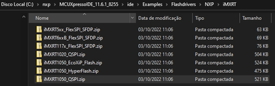

I'm working on a custom board, using the imxRT1051. We will use a NOR Octal flash memory for XIP.
I did a search for drivers (.cfx) to configure MCUXpresso and then load the firmware into memory but I didn't find any specific ones for this type of memory.
Would it be possible to provide the project for MCUXpresso with the code of some driver for NOR Octal SFDP? Or even indicate me some driver that works for this type of memory? I looked in the IDE folder with examples of flashdrivers but they aren't fit.

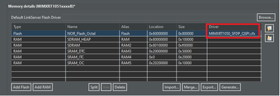

I was able to access the flash using the MCU Boot Utility.
Now I'm trying to generate/I need the .cfx to integrate in MCUXpresso and allow me to program the NOR flash Octal memory to be able to enter debug mode.

It worked, I could use the QSPI .cfx driver.
Thank you all for the help.
