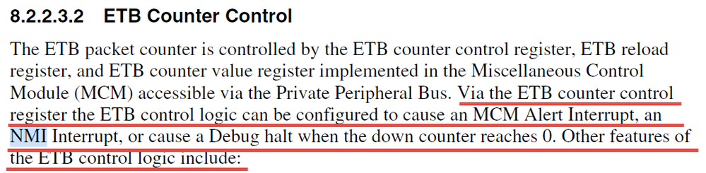

According to the RM, the ETB counter control can cause an NMI to interrupt, besides the Wakeup pin.
And please learn the information about the ETB via the below link.
https://static.docs.arm.com/ihi0029/e/coresight_v3_0_architecture_specification_IHI0029E.pdf

Thanks for the answer. That's what I read too. As I'm not using the coresight module neigter the WAKEUP pin, what could cause the NMI interrupt to trigger ?

As I know, there's no other trigger source yet except for the above two trigger source.
And from my experience, finding out how to replicate the phenomenon is essential, as it would provide some clues on this issue.
