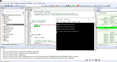

Hi, I am doing a research for a project for telemetry data storage. For that I need to use the NAND flash device on MIMXRT1170-EVKB through SEMC as a simple storage for raw data (without file system). I populated the DNP resistors on the data lines.
Now, to get me started, I would need some example showing how to store some data on the NAND flash, and read it later. Also I need to avoid using SDRAM device in any way and only utilize MCU built-in SRAM as operating memory (as in my intended project there will be no SDRAM on board).
Could you please provide some demo/example and guidance on how to achieve my goal? Thank you in advance.

  You want to run the MIMXRT1170-EVKB on board nandflash, right?
If yes, please :
1. hardware:
To make the examples works, please add resistors:
R1872,R1873,R1874,R1875,R1876,R1877,R1878,R1879
2. software
You can use the SDK demo:
SDK_2_14_0_MIMXRT1170-EVKB\boards\evkbmimxrt1170\component_examples\flash_component\semc_nand\cm7
This code will erase, program and read the data to the nandflash.
Wish it helps you!
Kerry
5,708 次查看
VojtechBaranek
Thank you @kerryzhou for your reply. I followed your advice and the demo really seems to be what I was looking for.
Unfortunately, the demo does not work properly for me. It always ends on Nand_Flash_Init because the status is failed. I went to debug the code, and it always fails in fsl_semc_nand_flash.c in function semc_nand_get_onfi_timing_configure on line 223 in condition:
if (nandOnfiParameterConfig.signature == nandOnfiTag)
where nandOnfiTag is previously defined as:
nandOnfiTag = FOUR_CHAR_CODE('O', 'N', 'F', 'I')
The actual ONFI parameter configuration, that has just been read on the previous lines, is full of zeros instead of meaningful values. Yet the status of that read operation was OK.
This is a very strange issue. It seems to me that the NAND flash is alive, but giving strange data. Couldn't this be caused by some mistake in the demo?
For instance, these macros below confuse me. The first one is completely unused, the other 2 are used. And I have no idea where these values came from.
#define EXAMPLE_SEMC_START_ADDRESS          (0x80000000U)
#define EXAMPLE_SEMC_NAND_AXI_START_ADDRESS (0x9E000000U)
#define EXAMPLE_SEMC_NAND_IPG_START_ADDRESS (0x00000000U)
Could you please think about what might be the cause and solution? I will be grateful for any help.
Thank you in advance. Best regards, Vojtech.
5,697 次查看
kerryzhou
Hi @VojtechBaranek ,
  I think, you may need to double check your hardware modification.
   If you still have issues, please tell me your used MIMXRT1170-EVKB version, then I will test it on my side.
Kerry
