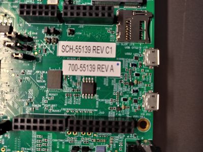

VojtechBaranek
Hi @kerryzhou
I double checked under microscope and all those 8 connecting resistors seem to be soldered OK. If no extra modifications (like moving some jumpers) must be done, it should work.
So if you have a possibility to test the demo on your side, I will be grateful, as it will help me know where to focus. To tell you my version of the board, I enclose these photos, which I hope contain that info.
Thank you.
Best regards Vojtech
