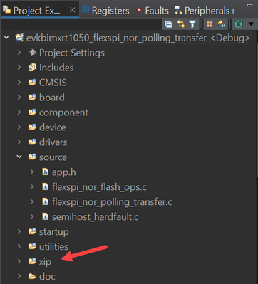

I've downloaded the most recent MCUxpresso development IDE for the IMRT1050-EVKB board. I attempted to program the QSPI memory but couldn't locate the "xip" folder within the latest SDK. Additionally, when I followed the instructions outlined in the AN12183 document to run a sample LED program, it executed in RAM only. I'm seeking guidance on configuring the system to execute the program from QSPI flash memory.
754 Views
EdwinHz
Hi @Harshaveeranki171,
Could you make sure you are using MCUXpresso IDE v11.8.1 as well as version 2.14 of the EVKB-IMXRT1050 SDK? The xip folder should be located inside the project folder, as such:
