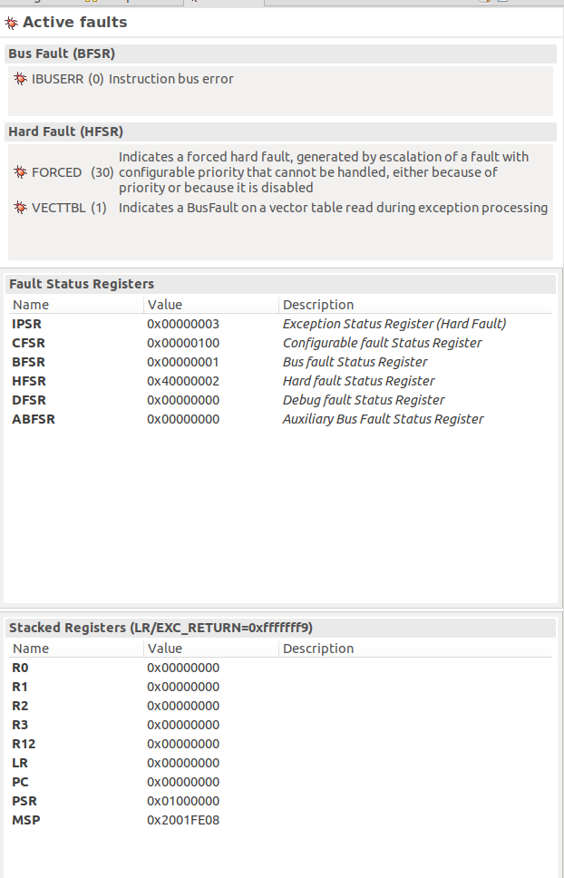

Coming now the hardfault: As in the flash_component_nor demo project I configure the clocks for the SPI as follows:
    /* Configure Clock for FlexSPI */
    const clock_usb_pll_config_t g_ccmConfigUsbPll = {.loopDivider = 0U};
    CLOCK_InitUsb1Pll(&g_ccmConfigUsbPll);
    CLOCK_InitUsb1Pfd(kCLOCK_Pfd0, 24);   /* Set PLL3 PFD0 clock 360MHZ. */
    CLOCK_SetMux(kCLOCK_FlexspiMux, 0x3); /* Choose PLL3 PFD0 clock as flexspi source clock. */
    CLOCK_SetDiv(kCLOCK_FlexspiDiv, 2);   /* flexspi clock 120M. */‍‍‍‍‍‍
But when executing CLOCK_InitUsb1Pdf(...) function the hardfault is caused by the last assignment in the this code:
void CLOCK_InitUsb1Pfd(clock_pfd_t pfd, uint8_t pfdFrac)
    uint32_t pfdIndex = (uint32_t)pfd;
    uint32_t pfd480;
    pfd480 = CCM_ANALOG->PFD_480 &
             ~(((uint32_t)((uint32_t)CCM_ANALOG_PFD_480_PFD0_CLKGATE_MASK | CCM_ANALOG_PFD_480_PFD0_FRAC_MASK)
                << (8UL * pfdIndex)));
    /* Disable the clock output first. */
    CCM_ANALOG->PFD_480 = pfd480 | ((uint32_t)CCM_ANALOG_PFD_480_PFD0_CLKGATE_MASK << (8UL * pfdIndex));
    /* Set the new value and enable output. */
   /* Hardfault originates here */
    CCM_ANALOG->PFD_480 = pfd480 | (CCM_ANALOG_PFD_480_PFD0_FRAC(pfdFrac) << (8UL * pfdIndex));

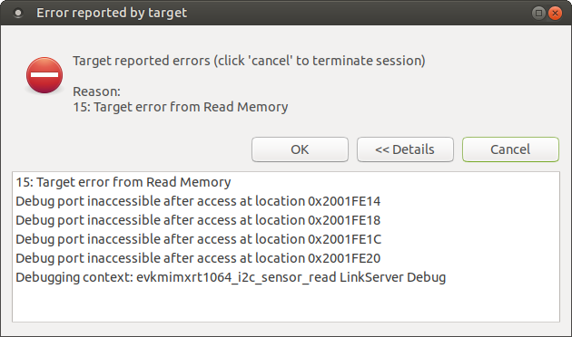

The debugger reported an error reading from inaccessible memory region:
And the corresponding fault view:
After this fault, the MX RT1064 is no longer acessible to flash new firmware and one has to change to "Serial Download" boot option. The corresponding flashing error is:
