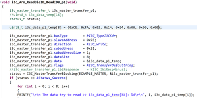

And I wish to reproduce the below I3C waveform via function "i3c_master_transfer_t".
The function I wrote as below:
However, the [Repeated Start Bit] is not appeared in this waveform:
In this case, I have a question wish to have brainstorm with you:
Can I add a [Repeated Start Bit] between "Slave address bit" and "Sub Address bit"?

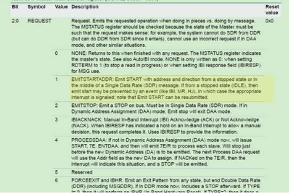

1. I was searching the MIPI_I3C_Spec, and I found the below command structure (Private RnW Transfer):
So, does MCUXPRESSO IDE have function for this private RnW data transfer?
2. According to your reply, I should call function [I3C_MasterRepeatedStart] in function [I3C_MasterTransferBlocking] as below, right?
But what should I actually write code to add only one [repeated start bit]?
Because the 3rd parameter of function [I3C_MasterRepeatedStart(base, transfer->busType, transfer->slaveAddress, kI3C_Read)] need to write the slaveAddress, and I don't need to re-send a slaveAddress here.
Can you provide some example to show how to modify here, thanks a millions times!
=>Do you need to use the private RnW Transfer?
I think you can write a new API like the I3C_MasterTransferBlocking for the private RnW transfer.
As I know, we didn't Add the private transfer API.

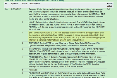

This is the I3C_MasterRepeatedStart, for the parameter, it should like this:
base, transfer->busType, transfer->slaveAddress, direction which is defined in :
masterXfer.slaveAddress = 0x30U;
masterXfer.data = g_master_rxBuff;
masterXfer.dataSize = I3C_DATA_LENGTH - 1U;
masterXfer.direction = kI3C_Read;
masterXfer.busType = kI3C_TypeI3CSdr;
masterXfer.flags = kI3C_TransferDefaultFlag;
masterXfer.ibiResponse = kI3C_IbiRespAckMandatory;
status_t I3C_MasterRepeatedStart(I3C_Type *base, i3c_bus_type_t type, uint8_t address, i3c_direction_t dir)
uint32_t mctrlVal;
/* Clear all flags. */
I3C_MasterClearStatusFlags(base, (uint32_t)kMasterClearFlags);
/* Issue start command. */
mctrlVal = base->MCTRL;
mctrlVal &= ~(I3C_MCTRL_TYPE_MASK | I3C_MCTRL_REQUEST_MASK | I3C_MCTRL_DIR_MASK | I3C_MCTRL_ADDR_MASK |
I3C_MCTRL_RDTERM_MASK);
mctrlVal |= I3C_MCTRL_TYPE(type) | I3C_MCTRL_REQUEST(kI3C_RequestEmitStartAddr) | I3C_MCTRL_DIR(dir) |
I3C_MCTRL_ADDR(address);
base->MCTRL = mctrlVal;
return kStatus_Success;
=> Yes
3.But what should I actually write code to add only one [repeated start bit]?
=> From the RT600, you can see the start will send with address:
So, I think, maybe you can write your own code instead of the SDK API, let the 7E as the address, then no data, then repeat start +address.
Wish it helps you!

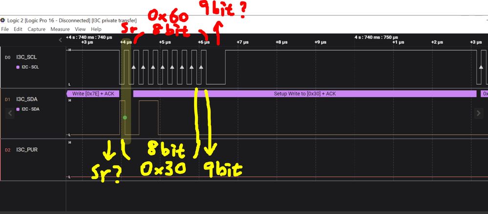

Below is my main command to send I3C_Write command:
And below is my modified "I3C_MasterTransferBlocking", the full code of "I3C_MasterTransferBlocking" can refer to attached txt file:
What I trying to do is adding a Stop Bit, and the command will generate a Start Bit when sending SubAddress Byte.
And here's the waveform I got:
In this waveform, I have few questions that troubled me:
Q1. The Slave Address I wrote is 0x7E, but what I sent in this waveform is 0x40.
       Also, the first byte only have 8 bits, the Ack bit is missing.
Q2. The Bit mark by left cursor (white line) is the "Stop Bit", right?
Q3. The Bit mark by right cursor (white line) is the "Re-Start Bit", right?
PS(Why I ask Q2 and Q3 is because the SDA seems not transient when SCL is High)
Q4. The SubAddress byte seem no problem, but the following data byte didn't send out.
       The command just end when finish the SubAddress byte.
Do you have any advises for above issues?

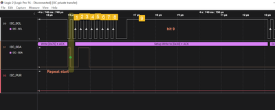

  Good news to you, the RT685 can support the private transfer, and we also don't need to modify the API, just when call the API, use the different flag and settings.
   Please check the following code in master:
    /* Reset dynamic address before DAA */
    memset(&masterXfer, 0, sizeof(masterXfer));
    masterXfer.slaveAddress   = 0x7EU; /* Broadcast address */
    masterXfer.subaddress     = 0x06U; /* CCC command RSTDAA */
    masterXfer.subaddressSize = 0U;
    masterXfer.direction      = kI3C_Write;
    masterXfer.flags          = kI3C_TransferNoStopFlag;
    result                    = I3C_MasterTransferBlocking(EXAMPLE_MASTER, &masterXfer);
    if (kStatus_Success != result)
        return result;
    masterXfer.slaveAddress = slaveAddr;
    masterXfer.data         = g_master_txBuff;
    masterXfer.dataSize     = I3C_DATA_LENGTH;
    if (result != kStatus_Success)
        return -1;
This is the test result:
You can see, repeated start already occur!
Please note, flag have different define.
Wish it helps you!
Kerry
18,683件の閲覧回数

In above coding, 0x7E is slave address; 0x30 is our register address.
However, we saw two issue with this coding:
1. The waveform still no "Repeated Start Bit" between 0x7E(slave address byte) and 0x30(register address byte).
2. The decode value of waveform is 0x7E > 0xCE > 0xFA > ... , it shows that 0x30 (register address byte) is missing.
Another question, after we check your testing result, I have question for below wavefom:
Cond1. Please check the Red Mark in below pic., if the first bit is "Repeated Start", then after 8 bit data is register address which is 0x60, not 0x30 we want.
However, the 9th bit is missing.
Cond2. Please check the Yellow Mark in below pic., if the first 8 bit is register address which is 0x30. And the 9th bit is parity bit which is 0 also.
However, the Repeated Start is still non-exist.
Can you verify which condition is correct for this waveform, and answer the following question?
Have a nice day,

  Your code is wrong:
masterXfer.slaveAddress = 0x7EU; /* Use Broadcast address to access slave*/
masterXfer.subaddress = 0x30U; /* Reg address */
return result;
The above 0X30 is not used, if you want to sendout 0X30, use the next frame:
masterXfer.data = &i3c_data_temp;
masterXfer.dataSize = 12;
return -1;
PRINTF("\r\n i3c_Arm_ReadDieID_WriteID0 Failed\r\n");
The wave which I give you contains the repeated start, just as your picture mentioned.
Wish it helps you!
Kerry

Jin_Tien
Hi @kerryzhou ,
I have one good news and one bad news after testing.
For good news, I can create the same waveform as you tested in first command.
>> [Start+0x7E+Write+Ack, Sr+0x18+Write+Ack, 0xCE, 0xFA, ... following data byte] >> transfer success.
But for bad news, I have another issue as below:
In the 2nd waveform from SCOUT (original I3C Master), the byte after Sr bit is 0x18+Read.
However, the following data is still transfer from Master to Slave.
So, our new question is, does the RT685 able to "Write" data into Slave when the direction is set as "Read"?
Have a nice day,
Jin Tien
