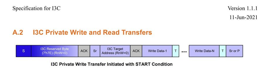

Hi everyone,

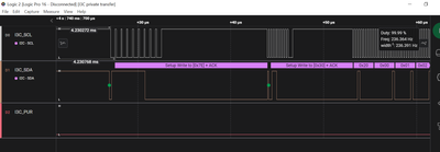

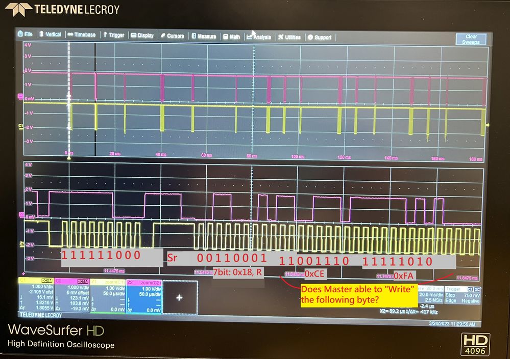

I have captured an I3C waveform as below picture:
The byte reading in this waveform as below:
Start, 0x7E (address, Write), [Repeated Start Bit], 0x31, .... , Stop

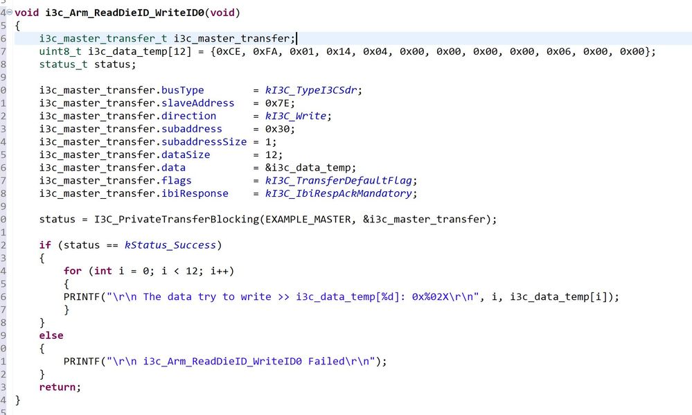

And I wish to reproduce the below I3C waveform via function "i3c_master_transfer_t".
The function I wrote as below:
However, the [Repeated Start Bit] is not appeared in this waveform:
In this case, I have a question wish to have brainstorm with you:
Can I add a [Repeated Start Bit] between "Slave address bit" and "Sub Address bit"?

Hi @Jin_Tien ,
   Just take the SDK I3C code as an example:
\SDK_2_12_0_MIMXRT685-AUD-EVK\boards\mimxrt685audevk\driver_examples\i3c\polling_b2b_transfer\master\iar
    /* subAddress = 0x01, data = g_master_rxBuff - read from slave.
      start + slaveaddress(w) + subAddress + repeated start + slaveaddress(r) + rx data buffer + stop */
    masterXfer.slaveAddress   = I3C_MASTER_SLAVE_ADDR_7BIT;
    masterXfer.direction      = kI3C_Read;
    masterXfer.busType        = kI3C_TypeI2C;
    masterXfer.subaddress     = (uint32_t)deviceAddress;
    masterXfer.subaddressSize = 1;
    masterXfer.data           = g_master_rxBuff;
    masterXfer.dataSize       = I3C_DATA_LENGTH - 1U;
    masterXfer.flags          = kI3C_TransferDefaultFlag;
    result = I3C_MasterTransferBlocking(EXAMPLE_MASTER, &masterXfer);
    if (result != kStatus_Success)
        return -1;
You can see, the sequence is:
So, between the  "Slave address bit" and "Sub Address bit", really no repeated start.
But in the following slaveaddress(r), it contains the repeated start.
If you want to add the repeated start between "Slave address bit" and "Sub Address bit", you need to modify the I3C_MasterTransferBlocking driver.
I3C_MasterRepeatedStart(base, transfer->busType, transfer->slaveAddress, kI3C_Read)
The above code will used to generate the repeated start.
Wish it helps you!

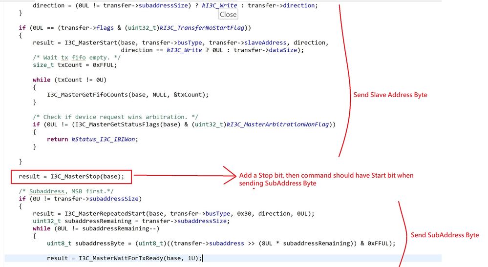

And below is my modified "I3C_MasterTransferBlocking", the full code of "I3C_MasterTransferBlocking" can refer to attached txt file:
What I trying to do is adding a Stop Bit, and the command will generate a Start Bit when sending SubAddress Byte.

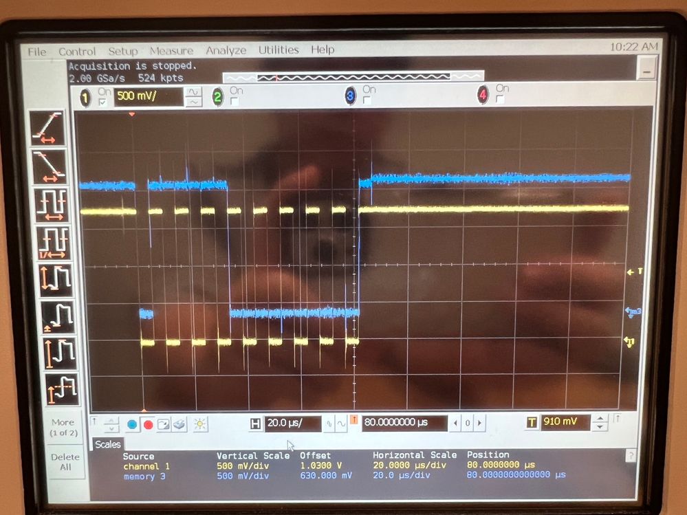

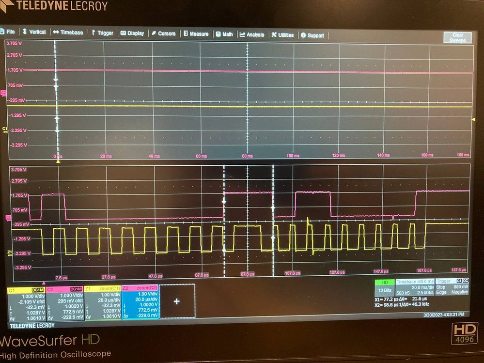

And here's the waveform I got:
In this waveform, I have few questions that troubled me:
Q1. The Slave Address I wrote is 0x7E, but what I sent in this waveform is 0x40.
       Also, the first byte only have 8 bits, the Ack bit is missing.
Q2. The Bit mark by left cursor (white line) is the "Stop Bit", right?
Q3. The Bit mark by right cursor (white line) is the "Re-Start Bit", right?
PS(Why I ask Q2 and Q3 is because the SDA seems not transient when SCL is High)
Q4. The SubAddress byte seem no problem, but the following data byte didn't send out.
       The command just end when finish the SubAddress byte.
Do you have any advises for above issues?

kerryzhou
Hi @Jin_Tien ,
    Please also upload your test project, I will find time to test it on my RT685-EVK board.
Kerry

kerryzhou
Hi @Jin_Tien ,
  Thanks for your patient!
  Good news to you, the RT685 can support the private transfer, and we also don't need to modify the API, just when call the API, use the different flag and settings.
   Please check the following code in master:
    /* Reset dynamic address before DAA */
    memset(&masterXfer, 0, sizeof(masterXfer));
    masterXfer.slaveAddress   = 0x7EU; /* Broadcast address */
    masterXfer.subaddress     = 0x06U; /* CCC command RSTDAA */
    masterXfer.subaddressSize = 0U;
    masterXfer.direction      = kI3C_Write;
    masterXfer.busType        = kI3C_TypeI3CSdr;
    masterXfer.flags          = kI3C_TransferNoStopFlag;
    masterXfer.ibiResponse    = kI3C_IbiRespAckMandatory;
    if (kStatus_Success != result)
        return result;
    masterXfer.slaveAddress = slaveAddr;
    masterXfer.data         = g_master_txBuff;
    masterXfer.dataSize     = I3C_DATA_LENGTH;
        return -1;
This is the test result:
You can see, repeated start already occur!
Please note, flag have different define.
Wish it helps you!
Kerry

In above coding, 0x7E is slave address; 0x30 is our register address.
However, we saw two issue with this coding:
1. The waveform still no "Repeated Start Bit" between 0x7E(slave address byte) and 0x30(register address byte).
2. The decode value of waveform is 0x7E > 0xCE > 0xFA > ... , it shows that 0x30 (register address byte) is missing.
Another question, after we check your testing result, I have question for below wavefom:
Cond1. Please check the Red Mark in below pic., if the first bit is "Repeated Start", then after 8 bit data is register address which is 0x60, not 0x30 we want.
However, the 9th bit is missing.
Cond2. Please check the Yellow Mark in below pic., if the first 8 bit is register address which is 0x30. And the 9th bit is parity bit which is 0 also.
However, the Repeated Start is still non-exist.
Can you verify which condition is correct for this waveform, and answer the following question?
Have a nice day,
Jin Tien

Jin_Tien
Hi @kerryzhou ,
I re-try the code you provide yesterday, but test result is still unexpected.
The code I modified as attached file: "Private RnW function test_Jin Tien_20230412_1030"
And it's output waveform as below:
Seems the 0x7E didn't send correctly, it becomes the 0x70.
And the 9th data bit is NACK because of the incorrect 0x7E.
Do you have any solution of this behavior?
Have a nice day,
Jin Tien

Jin_Tien
Hi @kerryzhou ,
I have one good news and one bad news after testing.
For good news, I can create the same waveform as you tested in first command.
>> [Start+0x7E+Write+Ack, Sr+0x18+Write+Ack, 0xCE, 0xFA, ... following data byte] >> transfer success.
But for bad news, I have another issue as below:
In the 2nd waveform from SCOUT (original I3C Master), the byte after Sr bit is 0x18+Read.
However, the following data is still transfer from Master to Slave.
So, our new question is, does the RT685 able to "Write" data into Slave when the direction is set as "Read"?
Have a nice day,
Jin Tien
