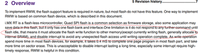

However, the evkmimxrt1180_ecat_foe_cm33 sample does not have a "linkerscript" folder. This causes the FoE procedure to generate a hardfault when the code attempts to write the first bytes to flash.
I copied the linkerscript folder from the evkmimxrt1180_ota_mcuboot_basic_cm33 sample and it seems to work.
Can you confirm that these are the exact same linkerscripts I need in the FoE sample?

I check the  linkerscript folder from the evkmimxrt1180_ota_mcuboot_basic_cm33 demo,
This linker script folder involves the allocation of Flash code to SRAM.
https://www.nxp.com/docs/en/application-note/AN12564.pdf
There are some relevant descriptions in this application note.
Have you performed any Flash write operations in your project? If so, you need to add this linker script folder.
