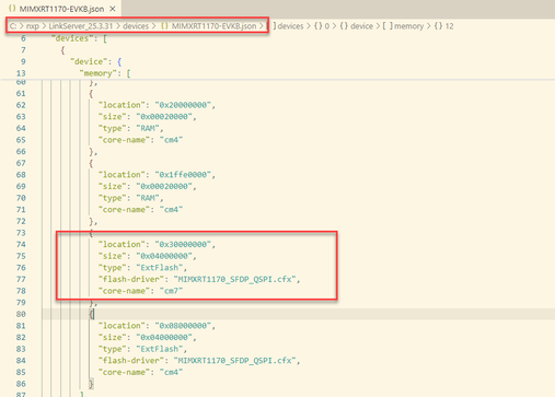

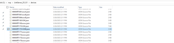

Hi @yosri_c
Could you try to modify the .json for the MCU?
I took the idea from this Erich Styger's post
https://mcuoneclipse.com/2023/07/30/using-legacy-devices-with-linkserver/
Or you could create your own device.
Please let me know your results.
Diego

yosri_c
Thank you diago for your support .
apologies for the late reply . it's flashing after i created my own json and removed the override option
