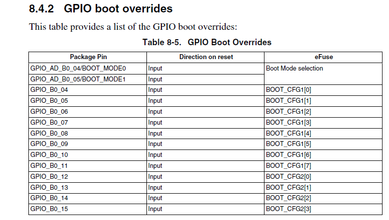

Thanks for the info. Actually the boot mode pins are correctly set to go into serial downloader mode, but the BOOT_CFG pins are used for other functionalities on our custom board and hence it is not possible to set them to any particular state externally. This is the reason why we can't execute from internal flash even though the chip is getting flashed over SWD/JTAG.
We want the chip to ignore the BOOT_CFG pins state on reset and for that reason we want to enter the serial downloader mode and blow the BT_FUSE_SEL efuse using the flashloader utility.
The problem is the sdphost application in the flashloader tools is not able to communicate with the chip even though the BOOT0 and BOOT1 pins are set correctly. It always returns error 5 (no response from target device). We want to know how to debug this - could it be a reset issue? Could it be something else? Is there any way to verify if the chip has entered serial downloader mode other than using the sdphost tool?

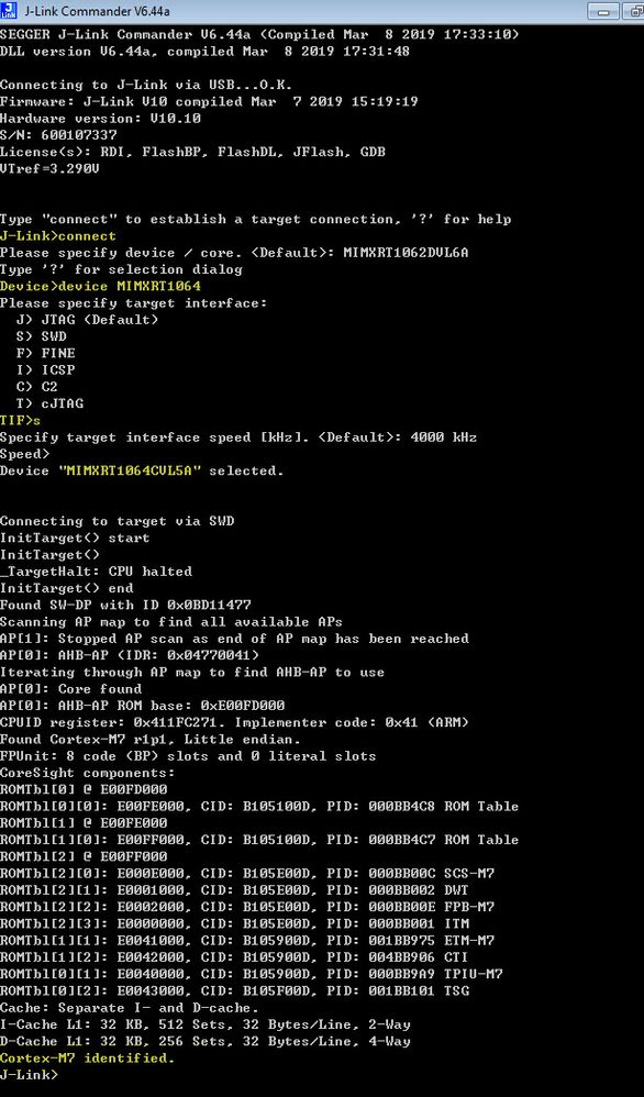

1. Do you leave the JTAG/SWD interface?
  Please use the JLINK debugger and JLINK commander to check your issue boards, whether you can find the ARM core or not?
  You can refer to my attached picture.
  If you even can't find the ARM cortex M7, then I can make sure your Board solder, especially the MCU connection side have problems.
  If you can find the ARM core, just when enter the serial download mode and reset the board, you can't use the UART or HID to connect or program the fuse.
  I think your UART, HID side connection to MCU related pins may have problems.

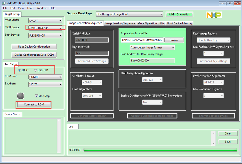

kerryzhou
Hi Mayuresh Manjrekar
    Your own designed board can be programmed with the debugger, and works OK right?
    If yes, and you want to enter the serial downloader mode, please check these points at first:
1. BOOT_MODE[1:0]=01,  serial downloader mode
2. BOOT_CFG1[0-7] and BOOT_CFG2[0-3] to 0:
  3. Use the MCUbootUtility tool to connect your board
https://github.com/JayHeng/NXP-MCUBootUtility/releases/tag/v2.0.0
The related user manual is:
Please try it again instead of the flashloader tool, this mcubootutility tool will be more easy to use.
Kerry
