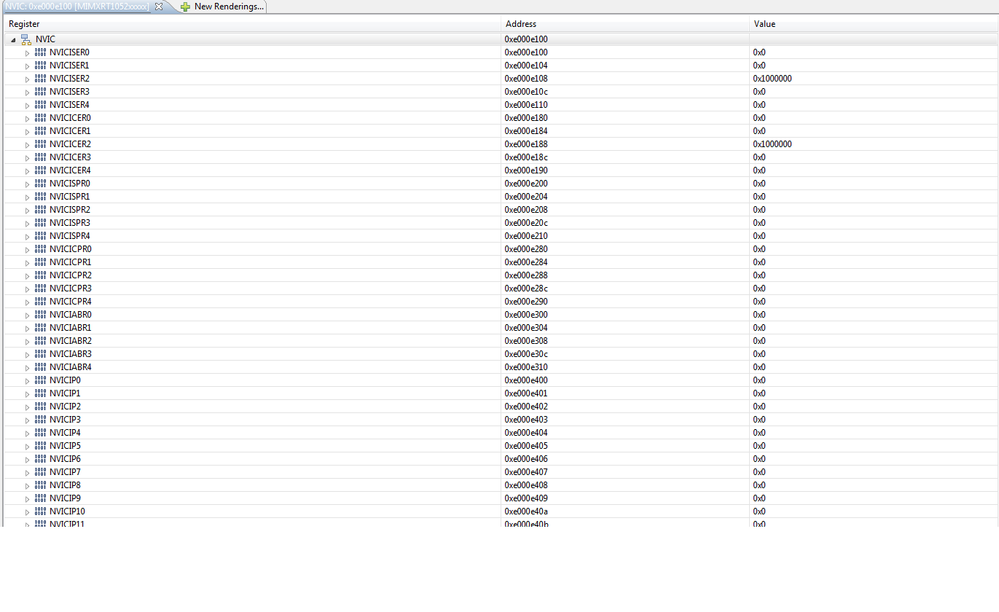

I don't understand why the interrupt is not serviced!
At the beginning, the state of NVIC registers is:

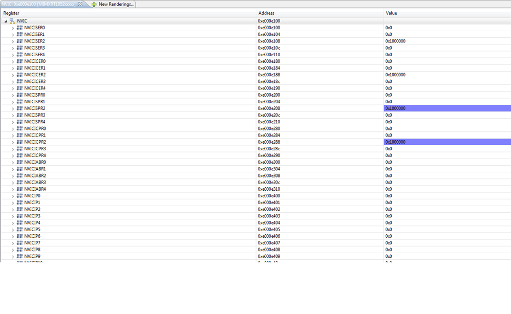

If I push the button, the interrupt is flagged but not serviced!!!
The ISR is not executed! Can someone tell me what is the problem?
Why the interrupt is not triggered although it is enabled?
