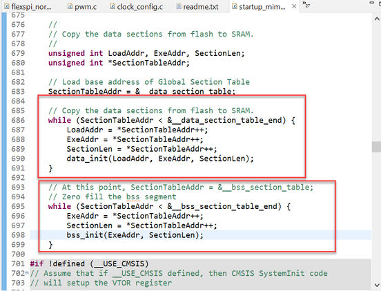

6) As other users have stated, we need good examples that show:
a) change default FlexRAM memory setup, - The default flexRAM setup can only be changed by burning the fuses, not the LD file at all.
b) RTL correct initialization of RAM (bss, data) in DTCM and OCRAM,
- The SDK does this task in the start up code, so LD file here just provides the pointers to application code . Please kindly refer to the following for details.

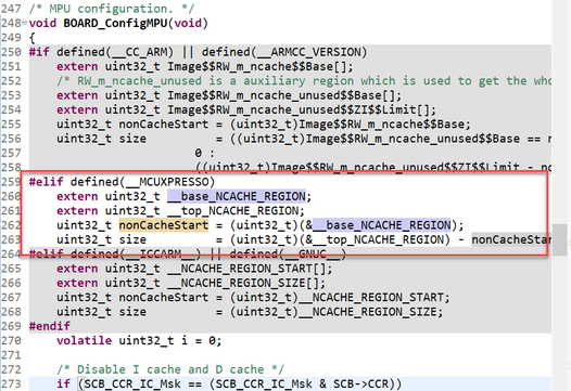

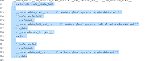

c) RTL correct initialization of caching;setup in this LD looks incorrect:
__NCACHE_REGION_START = ORIGIN(m_data2);
__NCACHE_REGION_SIZE = 0;
conflicts with later placement of non-cacheable data.
-Actually those definitions are used by IAR instead. MCUXpresso looks for the definition from the later non-cacheable data placement.
