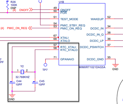

334 次查看
Habib_MS
Hello @alex_conway,
I asked internally in order to obtain more information regarding the nominal value and the impact of temperature on this oscillator. Thank you for your patience.
In the meantime, I have a question: could you share more details about how you are currently testing the WDOG timeout? If you are using the RT1020-EVK, please note that it includes an external 32kHz oscillator, which means it does not rely on the internal oscillator:
Habib
