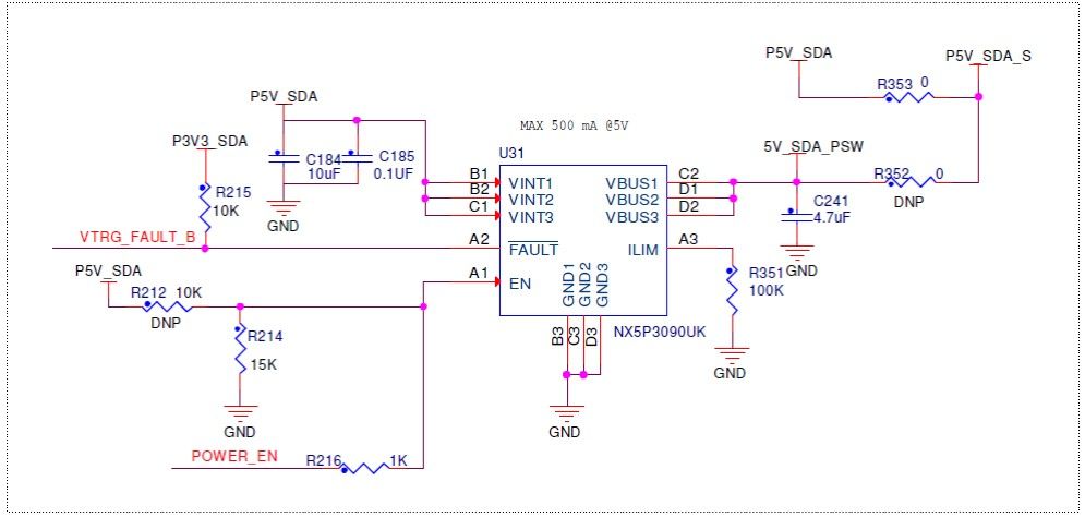

juan_mendoza
Hi Ed, Ryan,
Have you tried this?
If the EVK board exhibits intermittent operation, use a USB Y cable with two USB A to single micro B connector or an external power supply via the barrel jack (place a jumper across pins 1 and 2 of header J1) to power the board.
In addition to updating the firmware, a minor board modification is required to use the USB power switch that is part of the OpenSDA circuit. To do this you need to remove R353 and populate or solder across R352.
Juan Mendoza

Hi Ryan,
It can require double-headed USB cable for higher current capability on some laptops. Lower current capability can cause incorrect power sequence (see requirement for power sequence in device datasheet) during RT power up and this can lead into the boot failure. Another option is to move J1 to 1-2 and supply power through the barrel connector instead.
Carlos
