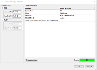

I am running a custom board with an i.MX RT1011 with the USB port connected to my PC. I'am trying to update the firmware using the onboard bootloader.
When jumping to the bootloader, the USB enumeration works and MCUXpresso Secure Provisioning recognizes the board:
When pressing OK the image can be build:
However, when going to the "Write image" tab and pressing the Write image button, it first succeeds loading the flashloader image. However when blhost is used to flash the image, it fails:

1,941 Views
MKlem
I might have find what is causing my problem.
My application uses the FlexRAM module to change the internal RAM to 64kb OCRAM 64kb DTCM 0kb ITCM
And with the debugger connected, I verified that this configuration sticks when jumping to the SDP. This might cause the bootloader to... undefined behaviour?
Is it possible to change the RAM segments back at runtime right before jumping into the bootloader? Or is that not possible? I am reading AN12077 but it's quite an intensive document to read.
Thanks!
Marcel
