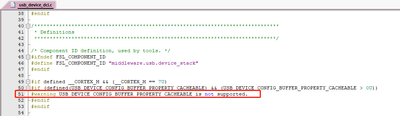

When i move "*NoCacheInit" section in OCRAM whitch config as Cacheable;
then, enable USB_DEVICE_CONFIG_BUFFER_PROPERTY_CACHEABLE = 1; but it was work failed.
We found a #warning "USB_DEVICE_CONFIG_BUFFER_PROPERTY_CACHEABLE is not supported."
The Cortex-M7 has Cache feature, why it was unsupported.

Hi @damonyun ,
USB_DEVICE_CONFIG_BUFFER_PROPERTY_CACHEABLE doesn't mean M7 hasn't cache or M7 doesn't support cache. It means you can't put USB buffer into cacheable area.
Please refer to this post for more details.
https://community.nxp.com/t5/i-MX-RT-Knowledge-Base/Using-NonCached-Memory-on-i-MXRT/ta-p/1183369
