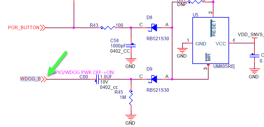

jeremyzhou
Firstly, Is the value of the AIRC Register always 0xFA050000 in two times calling?
Secondly, maybe you can consider another to reset the MCU, just like the below figures show, the MCU will be reset after output a low pulse via the WDOG_B pin.
TIC
7,866 Views

7,881 Views
georgemakarov
Hi!
Yes, AIRC register always has this value, no matter if it's first boot or has been reset by POR_B.
Regarding Wdog_b pin. The problem that we have produced 24k devices and they have been delivered to clients around the world. All of these devices have such issue.
Of course we won't burn SJC_DISABLE fuse anymore, but how we can resolve the problem for these 24k devices?
