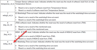

jeremyzhou
Firstly, Is the value of the AIRC Register always 0xFA050000 in two times calling?
Secondly, maybe you can consider another to reset the MCU, just like the below figures show, the MCU will be reset after output a low pulse via the WDOG_B pin.
TIC

7,855件の閲覧回数
jeremyzhou
I think you may misunderstand my suggestion, you can use the Watchdog timer to generate a system reset manually, just like the below figure shows.
In further, you can refer to the wdog01 demo in the SDK library to make it.
TIC
