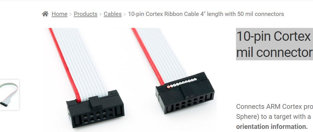

Could you share the datasheet of J6 connector (302-1-10P-SMT-D, Junhao) ?
I'd like to make cables for debugging i.MXRT board, but I couldn't find the connector dimension information.
Is it same as 20021511-00010T1LF of Amphenol ICC?

   Yes, any connector be connected as long as it meets the spec of 2x5pin & 50mil pitch connector can be used!
   You even also can use the standard JTAG interface if you design your own RT1170 board, then you can use the JLINK as the debugger.

This one for J6?
If this one, it is 2*5, 50mil interface, you just need to find the related cable.
As I know, the MCU-LINK should contains this cable, you can't find it, right?
10-pin Cortex Ribbon Cable 4″ length with 50 mil connectors
Wish it helps you!

Eugene3
Hi @kerryzhou
Thank you for your prompt replying.
I'll use MCU-Link Debug Probe, not Pro.
Actually I have not purchased the debugger yet, and I'm designing schematic of my application using RT1170. I'd like to use the same connector as the one on debugger in my application, but I couldn't find the connector spec.
I'm not familiar with SWD connector. Can any connector be connected as long as it meets the spec of 2x5pin & 50mil pitch connector?

kerryzhou
Hi @Eugene3 ,
Wish it helps you!
