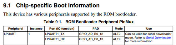

Regarding: On our custom board we dont have any specific connector for connecting to UPART1, so we took LPUART1 Tx and Rx pinout and connected those wires to USB to UART tx and rx pins along with ground.
Good point , please double check that you are using the specific LPUART1 pins for your part. Below the ones for RT1064 as example.
Also, SDK examples will use the same LPUART1 interface than the bootloader. It will be good to check using an LPUART example from the SDK. Where you can see data printed and type data in using a serial terminal.
