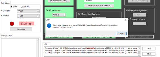

Hello Support team,
I am trying to connect the MCU boot utility with custom board via UART, but its not connecting. getting the error saying "Make sure that you have put MCU in SDP".
But I have made the boot mode configurations to 2'b01.
Attached image FYR.
Please suggest what could be issue.
Thank you.

diego_charles
Hi @Shiva-2022
I hope you are doing well.
I have seen in your picture that some BLHOST commands are being executed. But first the some SDPHOST commands need to be send, just to load the flashloader in internal SRAM. Then, flashloader will run and receive BLHOST commands.
Please  disable one step check box and click on reconnect and share with me full debug log from the tool. Also,  take a look  at the below  pointers to check:
-Is MCU being powered properly?
-Is VCOM correct?
-Did you reset or power cycled the MCU before entering serial downloader mode.
-Any previous fuse settings?
- If you debug by JTAG after setting serial mode . Where is the program counter?
-Do you have latest MCUboot Utility release?
Please let me know your results!
Diego

Shiva-2022
Hello Diego,
Thanks for the quick reply.
I have disabled the "One step" option in MCU utility and tried to reconect but the behaviour is same getting the same error as earlier.
Attached debug log from tool FYR.
Below are the answers for your points.
Ans: Yes
-Is VCOM correct?
Ans: Yes
Ans: Made the Boot mode configurations on switches and turned on MCU then started checking connection with board.
Ans: We didn't do any fuse settings.
Ans: We have not tried with debugger. Please let us know which workspace to use for this purpose.
Ans: I have downloaded the MCUBoot utility tool from https://github.com/JayHeng/NXP-MCUBootUtility
FYI. We are using LPUART1 interface with MCU utility.
On our custom board we dont have any specific connector for connecting to UPART1, so we took LPUART1 Tx and Rx pinout and connected those wires to USB to UART tx and rx pins along with ground.
Please suggest your inputs.
Have a good day.

diego_charles
Hi @Shiva-2022
Thanks for your reply and for providing more information !
 Regarding  :We have not tried with debugger. Please let us know which workspace to use for this purpose.
You can use and stand alone  debugger and any project. Here I halted the processor and read the PC. the address that I am reading commonly is related to bootROM execution.
Regarding: On our custom board we dont have any specific connector for connecting to UPART1, so we took LPUART1 Tx and Rx pinout and connected those wires to USB to UART tx and rx pins along with ground.
Good point , please double check that you are using the specific LPUART1 pins for your part. Below the ones for RT1064 as example.
Also, SDK examples will use the same LPUART1 interface than the bootloader. It will be good to check using an LPUART example from the SDK. Where you can see data printed and type data in using a serial terminal.
Another thing, if you got USB1  available you can try with this port as well, just to narrow down the issue further.
Diego.

Shiva-2022
Hello Diego,
Thank you.
We are able to connect with MCUBoot tool now.
