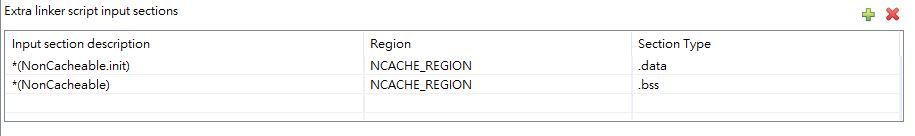

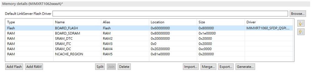

The other attachment "packet drop while boot to SDRAM.txt" is example code which modify memory details to boot to SDRAM.
The packet was dropped after ping for a while.
The code which I modified are as below,
May I ask why boot to SDRAM will effect the ping function?
Did I use the wrong way to config my project to boot to SDRAM?

ENET buffers need to store in non-cacheable region.  please try below code change.
Original definition:(enet_ethernetif_kinetis.c)
    SDK_ALIGN(static rx_buffer_t rxDataBuff_0[ENET_RXBD_NUM], FSL_ENET_BUFF_ALIGNMENT);
    SDK_ALIGN(static tx_buffer_t txDataBuff_0[ENET_TXBD_NUM], FSL_ENET_BUFF_ALIGNMENT);
Change to:
  AT_NONCACHEABLE_SECTION_ALIGN(static rx_buffer_t rxDataBuff_0[ENET_RXBD_NUM], FSL_ENET_BUFF_ALIGNMENT);
  AT_NONCACHEABLE_SECTION_ALIGN(static tx_buffer_t txDataBuff_0[ENET_TXBD_NUM], FSL_ENET_BUFF_ALIGNMENT);
