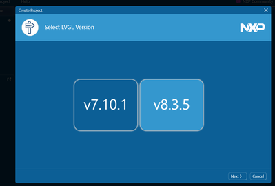

Hi @frozen ,
   Thank you for your interest in the NXP MIMXRT product, I would like to provide service for you.
   I already help you to check with our internal side, LVGL V9 is not supported now.
  We highly recommend you use the following LVGL version which is supported by the GUI Guider:
  Then, if you meet any issues, just kindly let us know.
Kerry

frozen
Hi @kerryzhou ,
Thanks for your support. I have to use v9, that's why I have to insist on not using Gui Guider with lvgl v8.3.5.
3,502 Views
kerryzhou
Hi @frozen ,
   I already check internally, the V9+SDK still in the progress internally, as V9 have a lot of difference with V8. So, until now, SDK support with V9 still not avaiable, thanks.
Kerry
