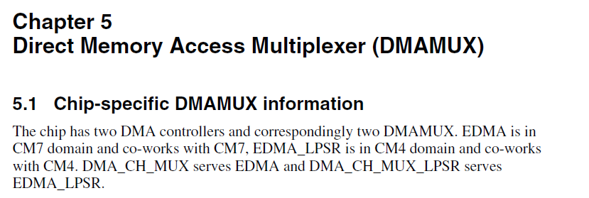

In IMXRT1170RM reference manual, It describe that "EDMA is in
CM7 domain and co-works with CM7, EDMA_LPSR is in CM4 domain and co-works
with CM4. "
Your code is in CM7, so please modify your code  DMAMUX1  to  DMAMUX0,  DMA1 to DMA0.

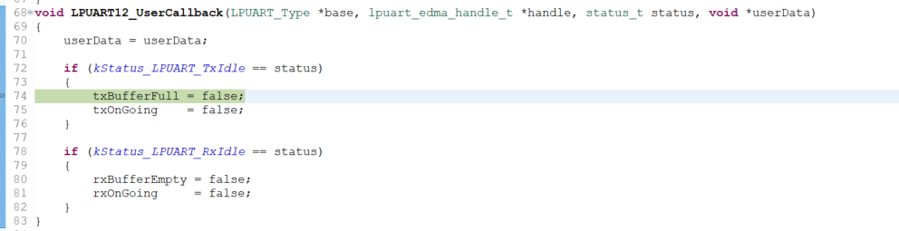

I set it as follows and confirmed that data is transmitted with LPUART12_Send_eDMA().
However, LPUART_UserCallback() is not called after transmission is completed.
When I check DMA1->INT, LPUART12_TX_DMA_CHANNEL bit is set to 1 and not cleared.
Q) Why is LPUART_UserCallback() not called?

void LPUART_UserCallback(LPUART_Type *base, lpuart_edma_handle_t *handle, status_t status, void *userData)
PRINTF("Callback\r\n");
if (((uint32_t)base & 0xFFFF0000) == DMA1_BASE)
if (kStatus_LPUART_TxIdle == status)
txOnGoing = false;
