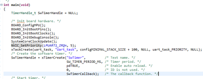

Add "NVIC_SetPriority(LPUART1_IRQn, 5);", and add the UART task to the scheduler for the initialization.
I was able to reproduce it by removing all but the initialization in the "uart_task" function, and just adding "LPUART_RTOS_Send(&handle, (uint8_t *)to_send, strlen(to_send));" inside the SwTimerCallback function to avoid the Receive function inside the example.

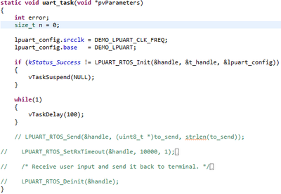

Could you please help me check all the includes, prototypes and definitions are in place? If so, please check for the priority line, and the UART TaskCreate function, the "Send" function inside the timer callback, and to comment the "Send" and all of the receiving part of the UART's task.

If it still doesn't work, please try adding a minimal delay after the UART initialization and try to communicate again.

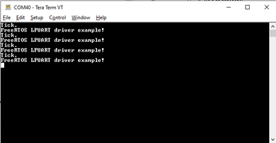

This is the constant output on terminal. "Tick." refers to the PRINTF inside the callback function, and the FreeRTOS LPUART line refers to the "LPUART_RTOS_Send" function.
I hope you find this helpful!
