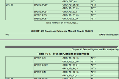

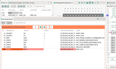

I'm using LSPI3 on the SLN-Local-IOT2 board. we are able to read all data from SPI using PCS0 pin(LPSPI3_PCS0 CSI_D05 - GPIO_AD_B1_12) for chipselec 1 PCS1 i need to use GPIO_EMC_29 i tried to change in MCUxpresso ide but tool is not allowing to change it. Is there any method to change it?
@kerryzhou
2,517 Views
kerryzhou
Hi @jinu_mohan
  You mean SLN-LOCAL2-IOT, the chip is RT106S, right?
  Please check the LPSPI3, your mentioned GPIO_EMC_29 is not the SPI3 PCS chips.
That's why you meet issues.

but due to some hardware constrains in sln-local-iot i couldn't use the  default LPSPI3 PCS1 - GPIO-AD-B0-04 PCS2 - GPIO-AD-B0-05 PCS2 - GPIO-AD-B0-06 i need to use multiple chipselect option is there any alternative method can we use.

LPSPI3 PCS1 - GPIO-AD-B0-04 PCS2 - GPIO-AD-B0-05 PCS2 - GPIO-AD-B0-06  these pins are used as boot pins and jtag can i use these pins for chipselect?
2,504 Views
kerryzhou
Hi @jinu_mohan ,
   I mean, the LPSPI3 IP related CS is the above list.
  You are right, it also multiple with other IP, but it can be used, to the boot, it is using during POR boot and reset boot, but after boot, you can use it.
   If you can't use the LPSPI3 IP hardware CS pin, I think you can use the other pin, use the GPIO function as the CS pin, but you need to add the GPIO control code. Eg, before you send the SPI data, CS GPOI pull low, after finished, pull high, this is also the normal used case, then you can use any other pin, just configure it as the GPIO is enough.
Wish it helps you!
Kerry
