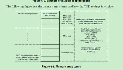

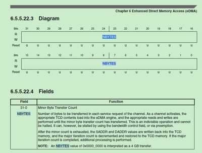

How many bytes of data can be handled in DMA in one request
@kerryzhou
2,797件の閲覧回数
kerryzhou
Hi @jinu_mohan ,
   If you have any new issues, you can create the new case.
   About one request, please check the RM DMA chapter, you will be clear:
Wish it helps you!
Kerry
