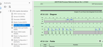

Please also share the I2C status register, check which detail error happens.
Do you have two MIMXRT1060 board? If yes, you can run it, one as master, and another as slave, then test it, and modify it to match your situation, it will be more easy to checking.
About the wave test, it's better to find a logic analyzer, that will be more easy to check the I2C bus and data.
Kerry
8,362 次查看
j_alex
Hello @kerryzhou , unfortunately i don't have another nxp neither a logic analyzer. I don't know how to share the I2C status register, but the error that i get is Kstatus_LPI2C_Fifo error when i test the status in my callback, i can see that the status is 903 which corresponds to the Kstatus_LPI2C_Fifo error.

  Do you debug the code, which IDE and debugger you are using?
  You can check the I2C register directly when you debug it:
Do you have the MIMXRT1060-EVK board?
If yes, you even can test this I2C code, as it will use the I2C to communicate with the on board I2C sensor:
SDK_2_11_1_EVK-MIMXRT1060\boards\evkmimxrt1060\demo_apps\bubble_peripheral
Kerry

Hello @kerryzhou i run the program in debug mode and i put a breakpoint in the function LPI2C_MasterGetStatusFlags to see the contents of the MSR and i get the following results, the function was called 5 times with the following values:
1- 1: TDF flag is set
2- 1: TDF flag is set
3- 769: TDF, EPF,SDF are set
4- 4864: EPF,SDF,FEF are set
5- 4865: TDF,EPF,SDF,FEF are set
hope that this will hepl you to figure out the cause of my problem.
8,346 次查看
j_alex
Hello, @kerryzhou I found the problem. the problem is that the LPI2C driver send a stop after the first send and the cause was that LPI2C does not work in debug mode unless you set the flag BGEN in the MCR so when i call the function  LPI2C_MasterTransferNonBlocking after reseting the FIFO i add the following command:
base->MCR |= LPI2C_MCR_DBGEN_MASK;
and now it works perfectly for the transmission part.
